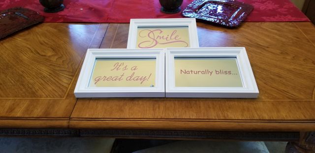

Engraved some mirrors for my granddaughter’s dorm room. Put some colored construction paper behind the etchings to give it some color and make it stand out.

Settings ?
Engrave from front or back?
@donkjr It is engraved from the back of the mirror. You have to reverse the image. It was done at about 200 mm/sec at 70% power. You have to experiment a bit because not all mirror backing is created equal. The first one I did, I had to go over twice because it did not burn all the material away to the glass.
