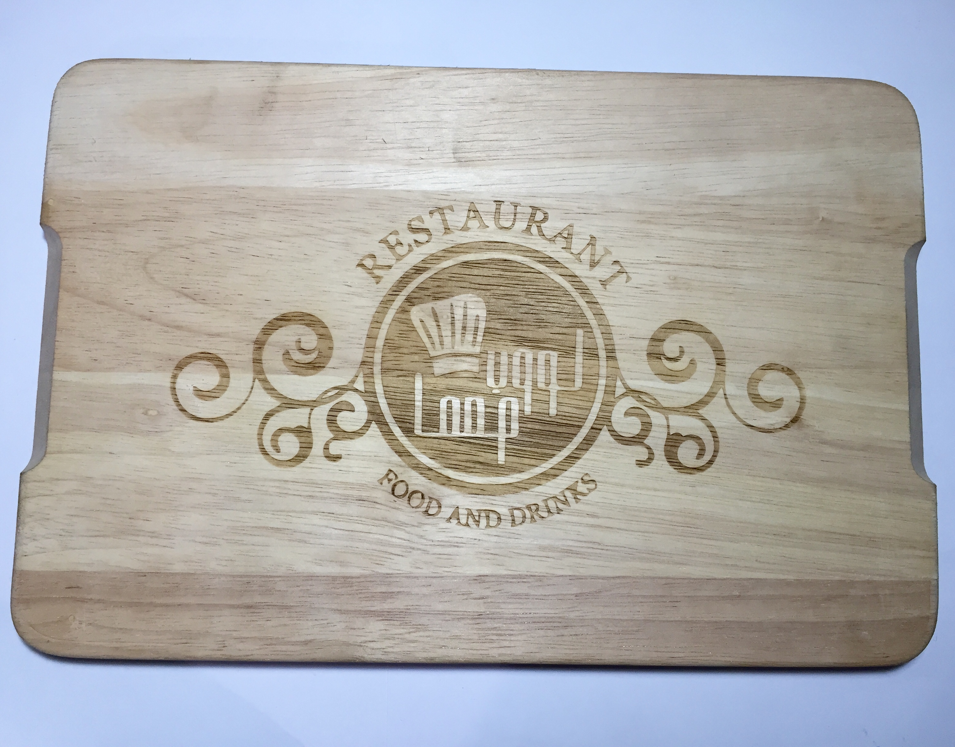

Engraved this today. I’m quite impressed how easy it engraved, I was using <5ma at 400mms. I think it’s come out pretty good. I am using a rubber wood chopping board as the material
This looks really nice. But I’m wondering where did you have to start the laser for this project to work. We’re you able to start in the center and it work around. It’s don’t know if you can with the program that comes with the laser if I can start a project from the center.
Hi there. Is what I done is create a white square the same size of the chopping board and then lined it up with the top right corner of the board. To get alignment correct I used a square of clear acrylic and done test fires on the acrylic to make sure it was aligned correct. The size of the chopping board is 300x200 so it’s at the limits of the cutting area so try to keep your design in the centre. Hope this helps!
David, I couldn’t help but notice, the restaurant name is “Loop” and it is written in Arabic as well. Am I right?
I have no idea if it is in Arabic or not I just googled restaurant logo templates and it came up
