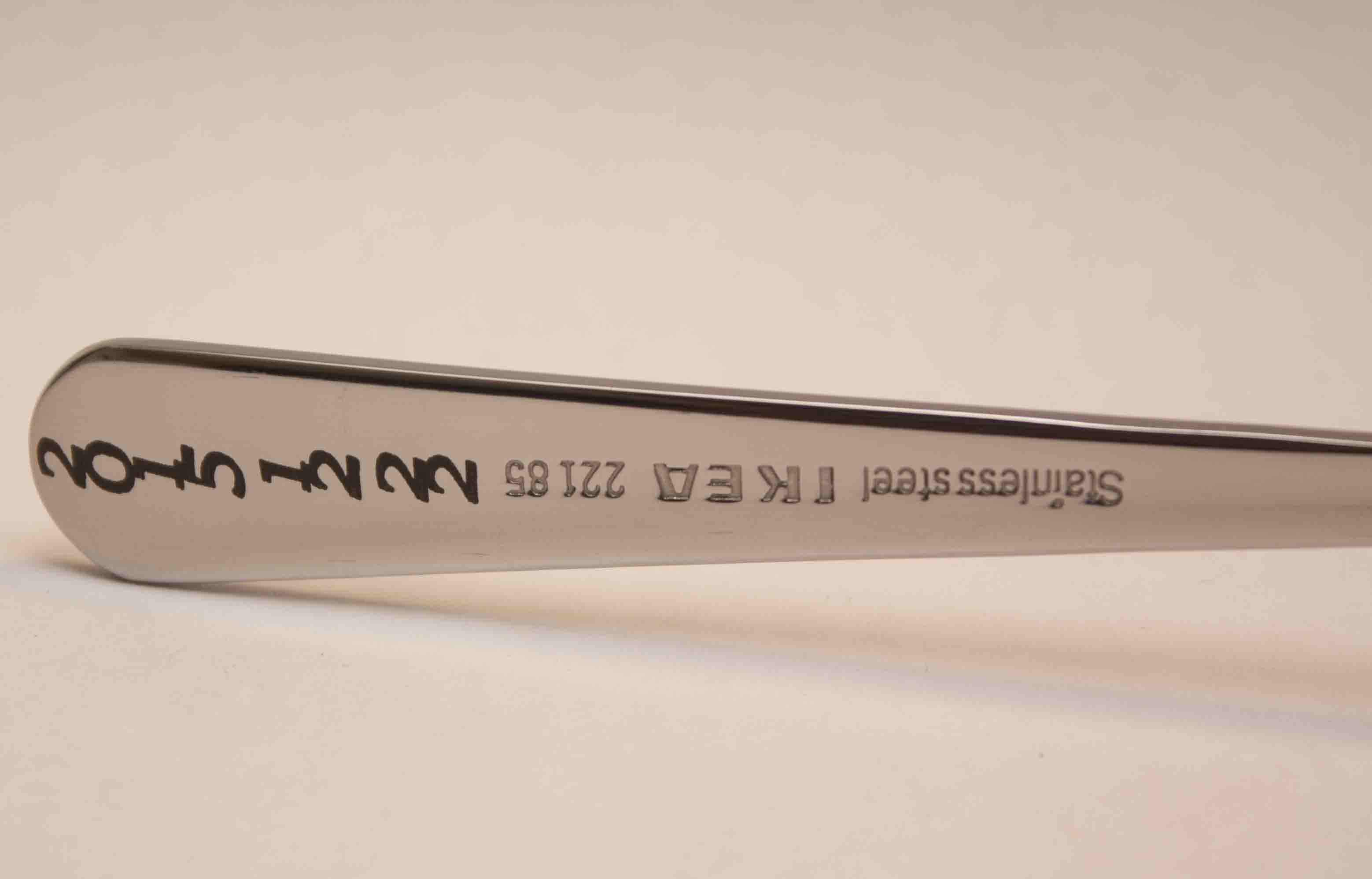

Engraving stainless steel
That’s interesting. I wasn’t sure these machines were capable of engraving stainless steel. Thanks for sharing.
Nice what is that white coat ?
With this can
Alright, thanks for the info man
How does it differ from using spray Moly lube as a marking agent?
Sorry I can’t compare Moly lube because i haven’t used it. But laser scriptor looks pretty good on stainless steel.
Very interesting and i am new to this laser you mean even cheap chinese laser machine will work with additive spray or we need to have metal laser engraving machine?
Anyone have a source for this spray in the USA?
Yes, cheap chinese laser (40w CO2) works well with additive spray. I’m using Brasil brand additive spray:
“Laser scriptor spray metal/black 300ml”
*Brazil
