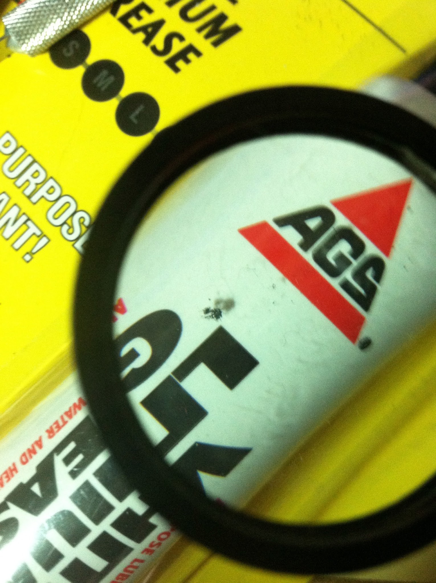

Enlarged pict of the black dust on Z axis thread rid grooves.
Enlarged pict of the black dust on Z axis thread rid grooves. Looks like filings almost. They carry a static charge. When I bring the Xacto blade to touch it, it jumps to a new location on the plastic background.
Still having Z axis issues on +printerbot simple beta.
I got the same, but i keep my printer greesed up. End result is black greese (starts white) Try some greese to keep it contained . Bad alignment on the bearings is what causes it i think, that and or stuff inside the bearings in my case.
Thats because those are filings. Its possible to end up with nearly a bare rod after a while. Thats especially the case with steel or galvanized rods. I prefer stainless rods with brass nuts. Brass is ‘self-lubricating’ and doesnt tear up the rods as badly.
@Addidis_no Thanks for the tip. Last night I put on a bunch of lithium grease and went back to a flexible tubing coupling between the stepper and the rod. The grease is dark gray already. Z Axis is positioning more repeatably.
