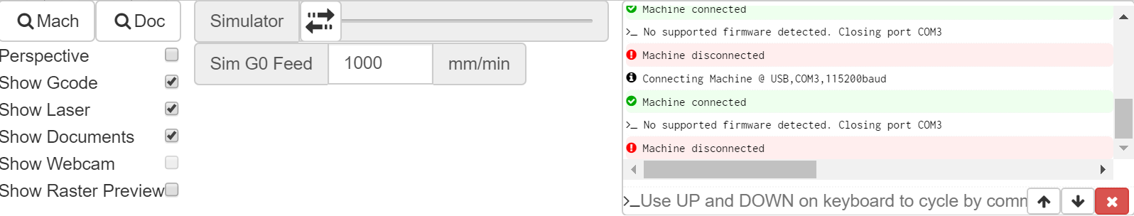

I am trying to use LaserWeb4 for my first time but receive the No supported firmware detected message when trying to connect. I’ve been through other support items and it’s clear my board is not supplying the proper version of firmware as LW4 would expect. I have tried using the RESET_ON_CONNECT=1 in the .env file but it did not change the behavior. I then added LOG_LEVEL=3 to the .env file. This also did not change behavior or create the log file. It appears the .env file is being ignored on my Windows 10 machine.
Each time I tried this I shut down and restarted LW4.
I first tried this procedure in *C:\Users\username\AppData\Local\Programs\lw.comm-server*
I also tried the .env procedures in another lw.comm-server folder I found located at *C:\Users\username\AppData\Roaming\lw.comm-server*
Neither location worked.
PuTTY gives this when pressing ctrl-x
Ortur Laser Master 2 Ready!
OLF 137.
Grbl 1.1f [‘$’ for help]

The status messages tell me that the board was not sending any messages, otherwise you would see the messages in the terminal area. Are you sure that COM3 is the correct port?
The “.env” file has to be place at the location where the exe is. Check the properties of the LaserWeb desktop icon to see where this is. And you should check that the env file is named correctly: only “.env” with nothing before the dot or after the env!!! You may need to change the windows settings to show file extensions of known file type. By default, windows hides endings like “.txt”, so you ony see “.env” when the filename is “.env.txt”.
By the way: With RESET_ON_CONNECT=1 LaserWeb sends a ctrl-x to the board right after connecting. If that doesn’t work, it might help to disconnect and reconnect the USB right after clicking connect in LaserWeb.
The problem also might me caused by the changes that Ortur did when porting grbl to STM32, but I would need such a controller board the test that.

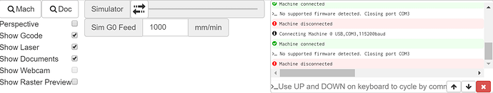

Below are screen shots. Note .env changed to look like a text file after I told Windows 10 to always open this .env in notepad.
Below is the command prompt with all the files in that directory. To be sure I’m running from the same directory I ran C:\Users\%username%\AppData\Local\Programs\lw.comm-server>LaserWeb.exe
Note .env appears to be properly named.
