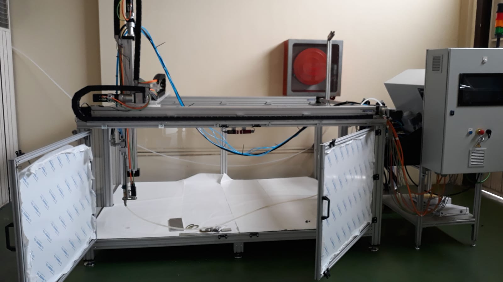

Some time ago, I asked , in g+ diy group, for an industrial grade cnc electronic In order to make a big 3D epoxy resin printer.
Well, the protect is under construction now.
The working area it is about 1800x1200x600 mm. It is not for made at home:rofl:
The electronic cabinets are made, the linear rails are assembled , the dosing unit is ready, and I expect to finish the printer in 1 month.
I will post some photos about this machine when I found the option of add photos what the phone to this forum.
More details coming soon…

Hello.
The epoxy resin is 2k compound. 1 part is resin and the other is the hardener .
Hardening is induced by chemical reaction after mixing both parts with a static mixer. The viscosity is arround 500.000 mPas. The resin is under development.
May be added, in the future, fiber glass, in order to do the compound more strong.
The nozzle is 1 or 2 cm square. The maximun flow can be arround 2,5 ltrs/min, and the movements of the 4 axis will be 2 mtrs/seg.
If you are thinking in mix sawdust with resin, the bigest problem can be to pump the sawdust at the exact quantity. For the chemical reaction to occur, the 2 compounds have to be dosed at the correct mixing rate. It is very important.
For the cleaning, there are 3 options:
1.- thow away the mixer, after use.
2.- clean the mixer pumpig only the compound A (no rective part)
3.- clean the mixer with solven, and then blow with air.
When the chemical reaction starts, there is an open time, in this time you can clean the mixer and work with it. After this open time, if you did not clean the mixer, it will be block.
If you want to make chairs with sawdust, will be a good idea pre -mix the part A with the sawdust first. For pump this fluid, a screw pump will work well. For the B part, a gear pump will be enough.
Actual state of the proyect.

Thanks. The proyect is in test fase now. Yesterday the first work was printed, with poor quality.
But today, the printed was good. The especial epoxy is working. It is the first formulation.
Will be more info next weeks.

At this time the inclusion of charges in the chemical formulation is not planned, because the dosing unit works with gear pumps.
There is a proyect to make other dosing unit with screw pumps in orther to include fiber glass or similar, but not at this moment.

Well, actually the dosing unit is working very well with gear pumps. The actual ratio is 1.9:1 and the time necessary to harder the mixture is about 2 minutes when a infrared heater is used. The dosing unit needs gear pumps because if it is necessary to change the ratio, it will be do very easy.
Using pistons is more complicated. The ratio is changed replacing one of the cilinder. Maybe is the most precise system, I know it. whit gears pumps the flow does not stop any time and I can made very big pieces with a constan flow.
A second dosing unit is coming in order to be mounted with a Kuka robot, it will not be a Cartesian system.
I’m actually using a commercial dosing unit, and the price is very expensive.
I am planing to make my own dosing system using an arduino plc.
If some one wants help coding, let me know, because I never programmed an arduino, and will need help.
