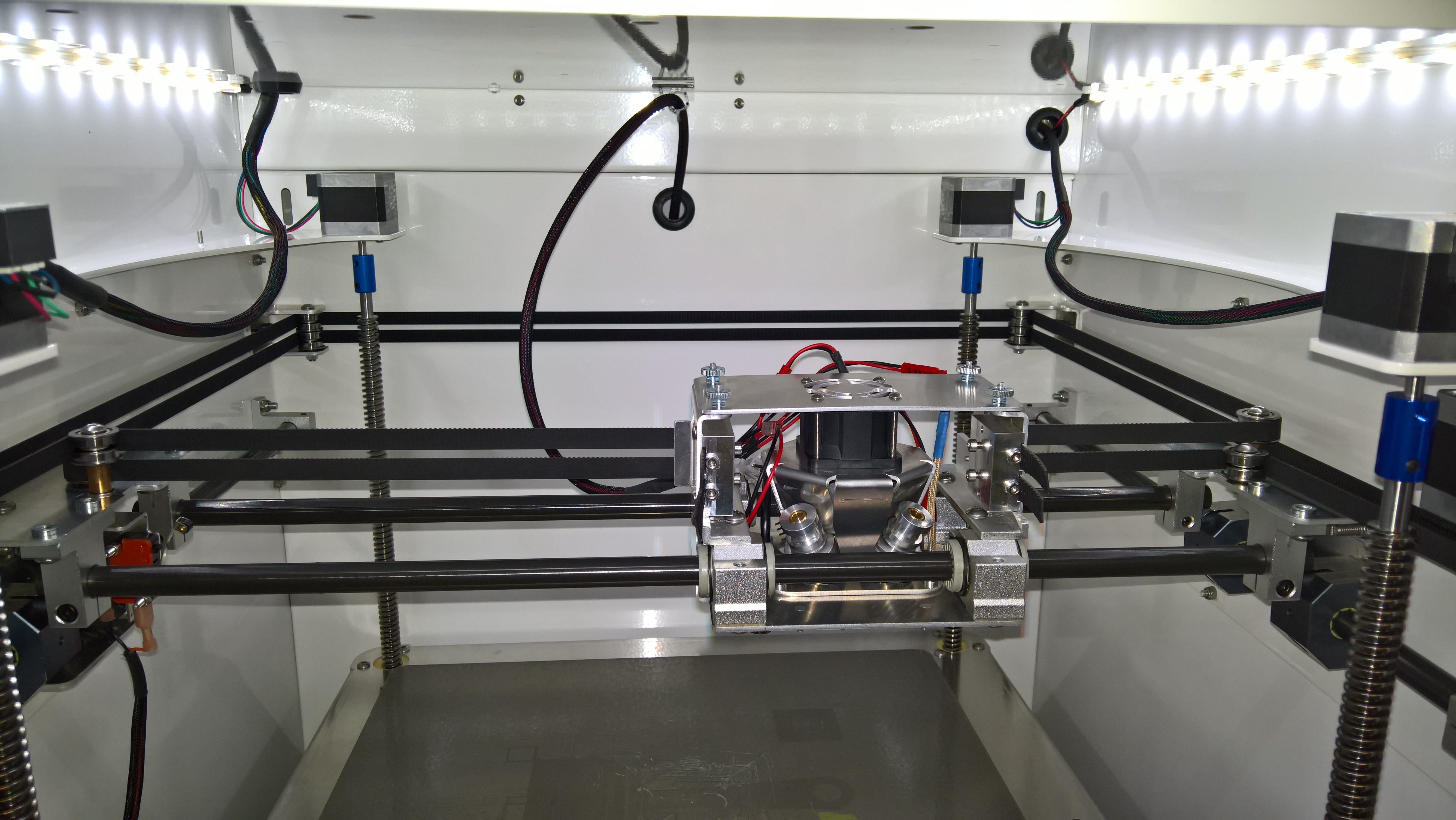

Eric I need your expertise, hope you can help. I have designed a core xy system but I am having trouble with layer shifting and print surface ossicillation at speeds beyond 50mm/s … my system uses two separate belt lengths on different planes … so not a single belt that crosses in the back. I also wonder what should my belt tension should be. Also what are the best tips you could offer to me to help me double check my design. I will post some pictures shortly for review. Thanks very much for any help you or anyone else could provide.

Let’s start with pictures of the design, then pictures of the prints. That will give the group a frame of reference to begin troubleshooting.
You can insert pictures in comments now on G+ so just add them into this thread.

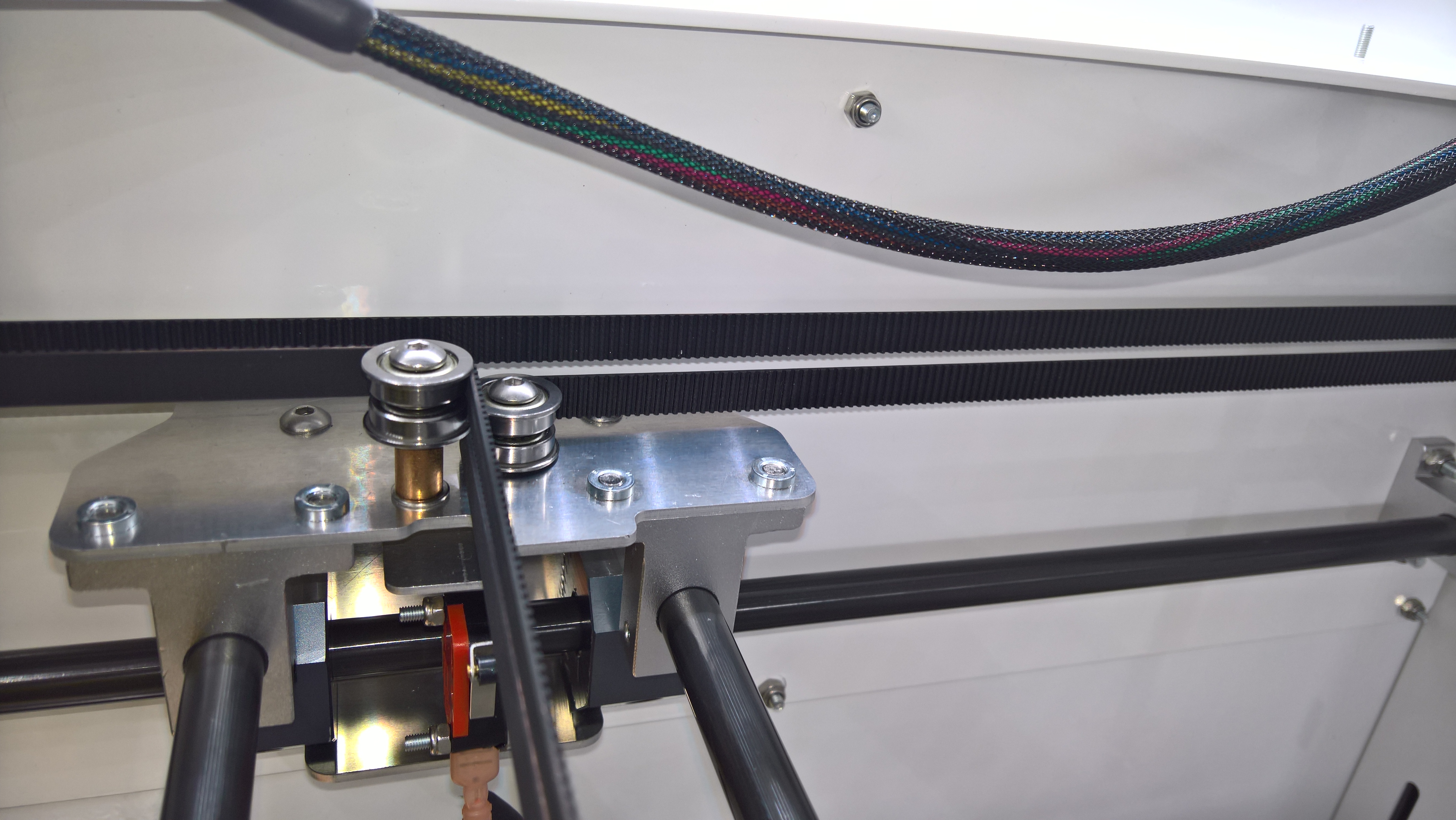

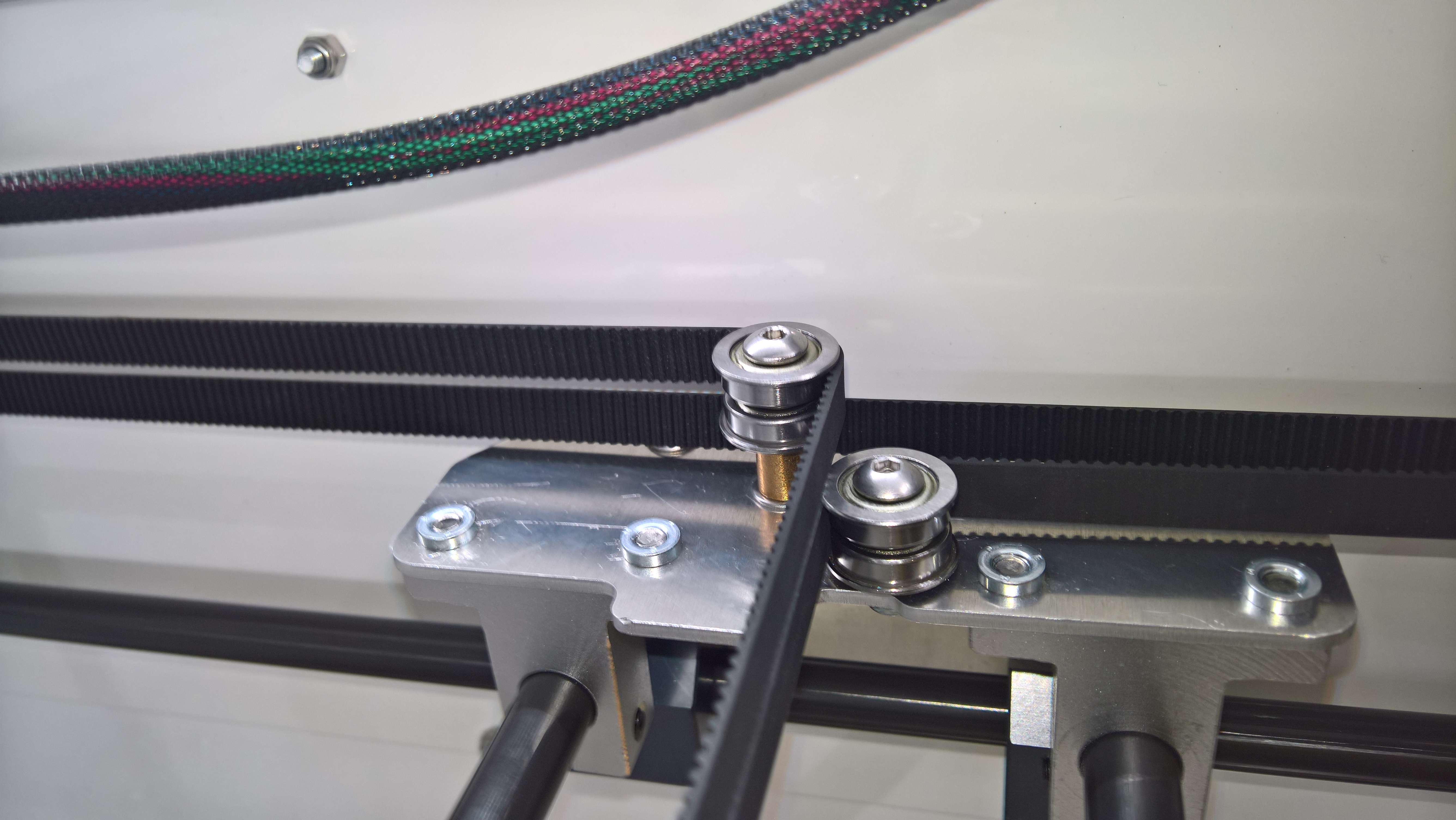

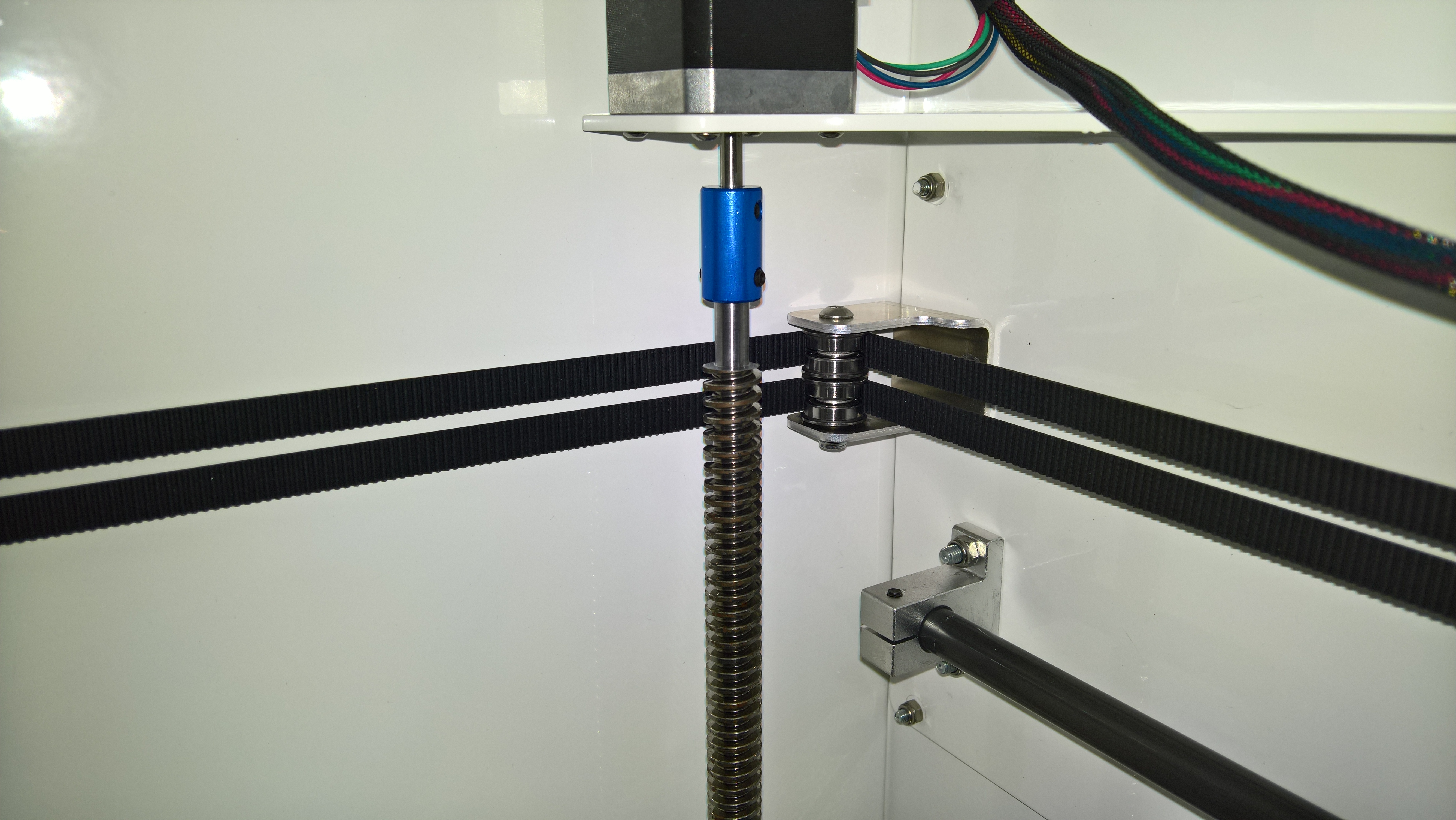

@Eclsnowman Hope these give you enough insight into my project?
My first thoughts for noise is resonance of the large flat panels. That coupled with any misalignment of the side roads causing chatter.
