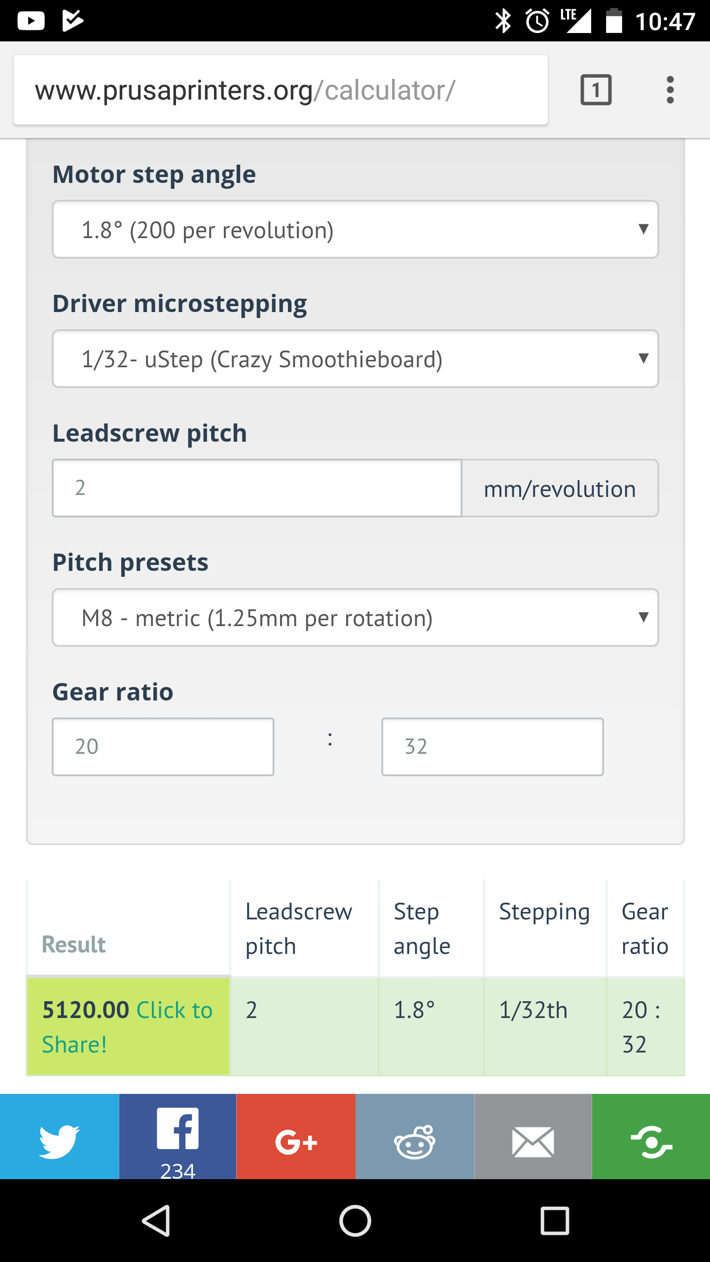

Ok. Somehow my gamma steps per mm was set to 2560 while the others are set to 160. Should these be the same? I changed it to 160.
Now I can move the Z axis up and down, but when I press home it moves about 2-3 inches or so and then give the halt or m999 message on the Viki display.
What should the stepping really be for X, Y, and Z?

5120
@Eclsnowman I tried setting it to 5120 but I get this error when I try to home Z if Z isn’t close to the end stop: Error: Homing cycle failed.
Also whenever I try to move Z down 100mm with S3D, it only moves the Z axis about 10mm.
Ok. It’s not having any trouble homing Z anymore, but moving Z down 100mm doesn’t work. It only moves about 10mm.
