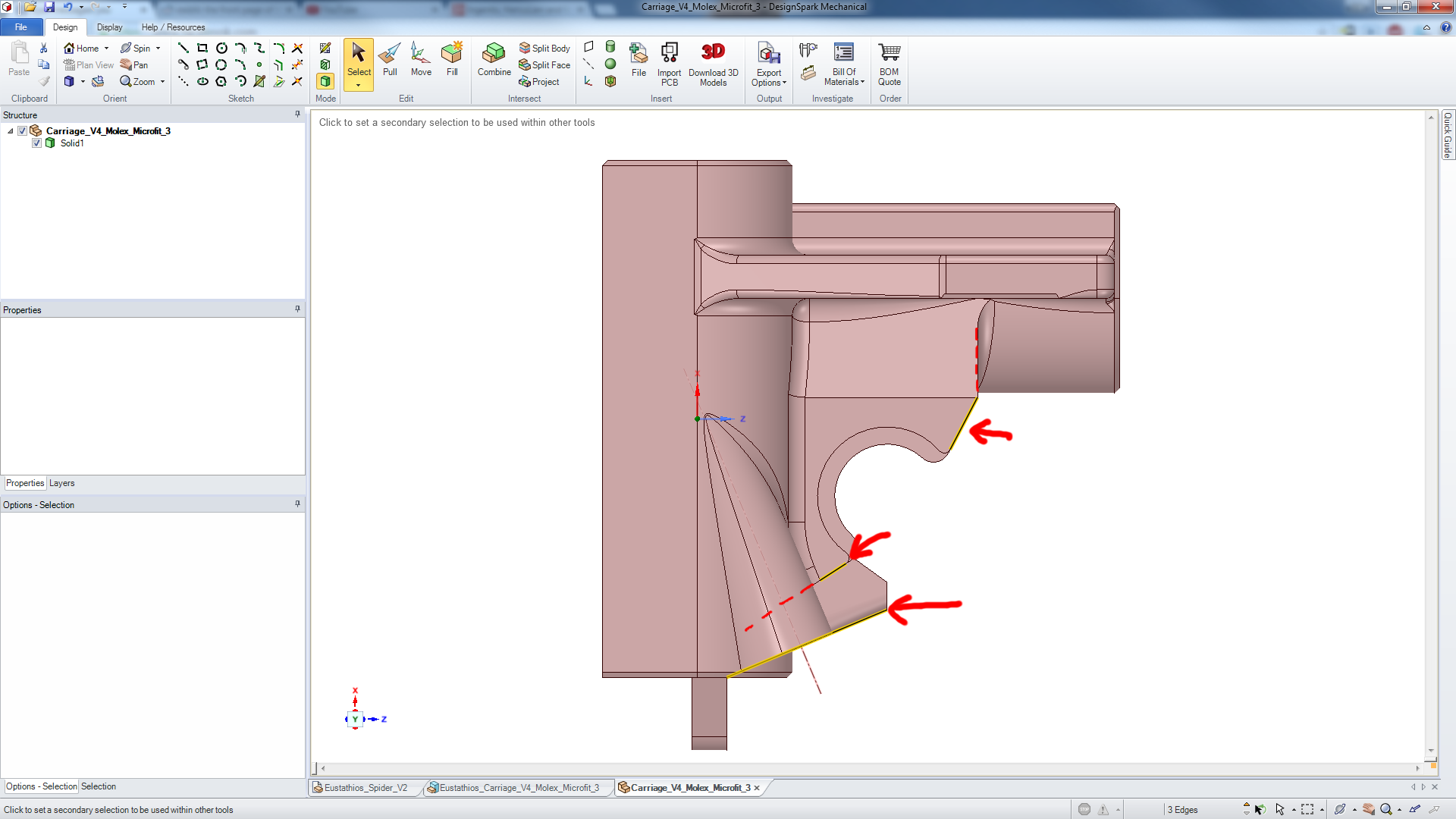

@Eclsnowman Would you mind sharing how you came about the angles shown here? I can measure the angles, but they’re all like 23.8818 and the decimals keep coming if I increase precision. I’m trying to re-cad the carriage with a clamp-style mounting method and I want to keep things as compatible as possible.
It was done by modeling in assembly based on how I located the fan. The fan was located based on distances, not angles. So it might be difficult to do based on angles unless you just choose a new one… Then redraw the bosses based on that new angle.
Do you know those positions and distances?
I will have to go back and look at the solidworks tree. I will try to look tonight.
Alright, thanks. Much appreciated.
Sorry for the delay. Yeah the way I built the features is messy. It should probably be adjusted. I mated the back of the fan to the angle face created by this loft extrude: http://i.imgur.com/MtqIPHP.png
The loft was designed to create a shell frame for the duct around the axis that I had defined for the hot end location.
It works but would make for one hell of an ugly print to fully define the model. So I think it would be worth it to set the feature based on an angle, the redefine things based on that.
Interesting. I tried my hardest to find a nice dimension that defined that plane, but nothing seemed to work. So I figured it fell out of the fan placement which in turn was defined by something else. I guess not. Looks like I may change the design slightly there as well. Thanks for the response though! Much appreciated, sir!
