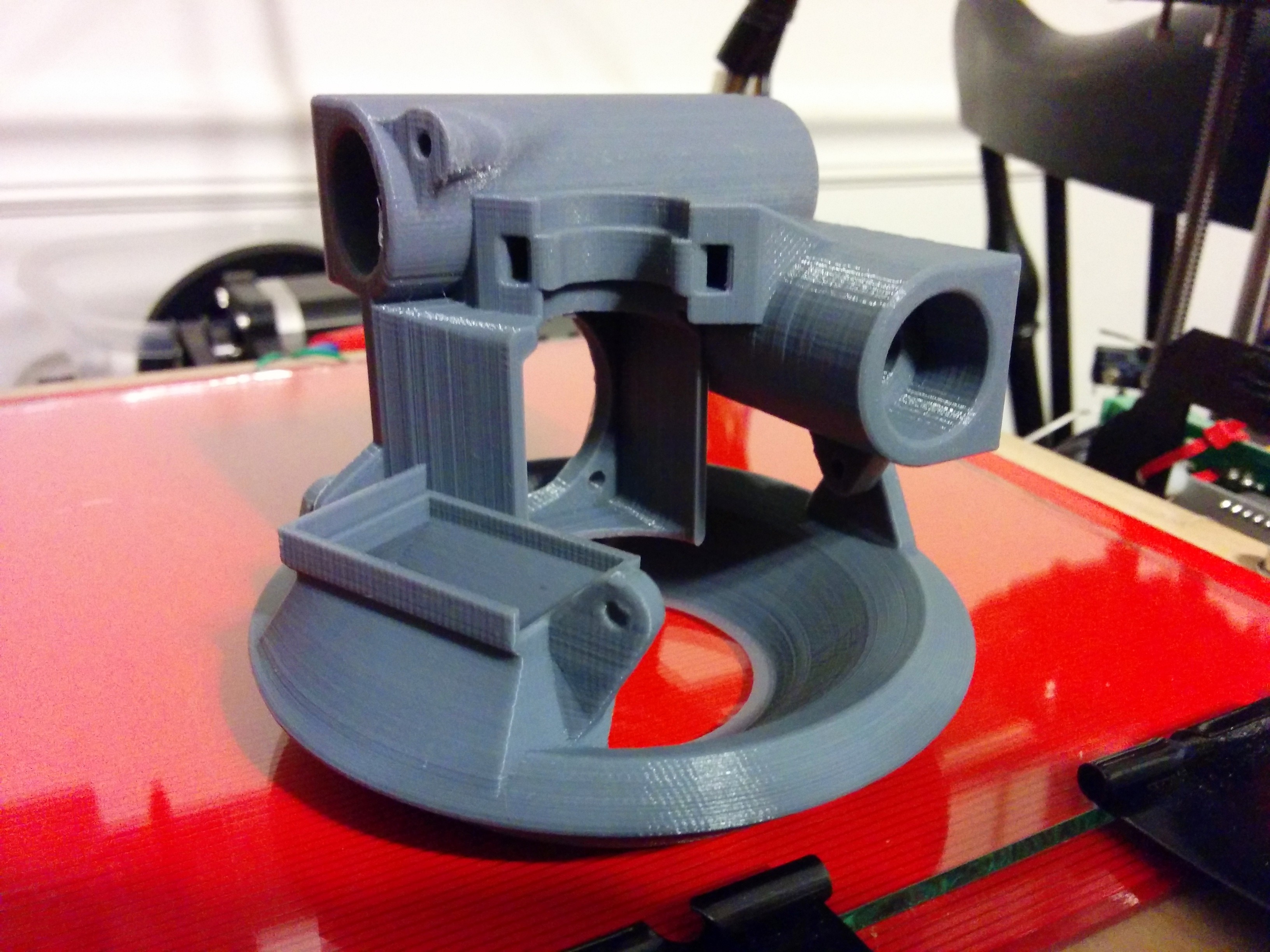

@Eclsnowman you sure did design a lovely part here.
Whoa, that is quite something. So is this replacing the dual extruder already in the Herculien?
@Dat_Chu right now it is for the Eustathios. But if I changed the hole between the bushings to something over 10mm it would work fine for HercuLien too. I am torn. I like the flexibility dual heads provide. But to be honest I Never utilize it, so single extruder and lower weight would likely be a smarter move for me.
@Jim_Wilson BTW great looking print quality. Nice job.
That is awesome. I’m sold. Starting the print tomorrow.
@Jason_Smith I was thinking about modifying it for cable strain relief zip tie spots. Give me a day of so to play around.
Oh no! Hes redesigning it! If I only I had some sort of machine that could produce multiple iterations of a prototype in mere hours at practically no cost in materia-MUAHAHAHAHAHAHA!

Guess I’m a little late to the party, but was this printed in PLA or ABS? At the moment, I can only do PLA, but I’m really liking this and I might be willing to give up my second hotend that I never use for this. So, would PLA be up to the task? I’m worried about that duct around the heatsink.
This is in pla. Haven’t tested this particular model yet, but my whole carriage and ducting on my i2 is pla, with a fan right on the heatsink of the e3d v6 it doesn’t radiate any noticeable heat.
