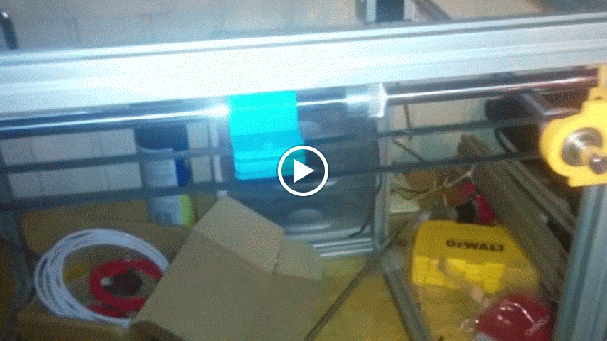

@Eclsnowman , your initial comment about belt tension worried me a little, so I have a solution! Loosen up the bearing holders on each side slightly and pull them away from the t slot. Then attach belt and screw bearing holders back down.
If they slack off over time, I’ll cut off a tooth from the edge of a belt and do it again, pulling it in slightly further.
