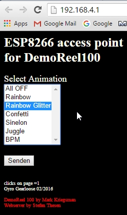

ESP8266 Access Point for DemoReel 100
Create your own WLAN access point anywere and control the lights via your phone. FastLED runs entirely on the ESP8266 chip ! No Arduino / Teensy needed.

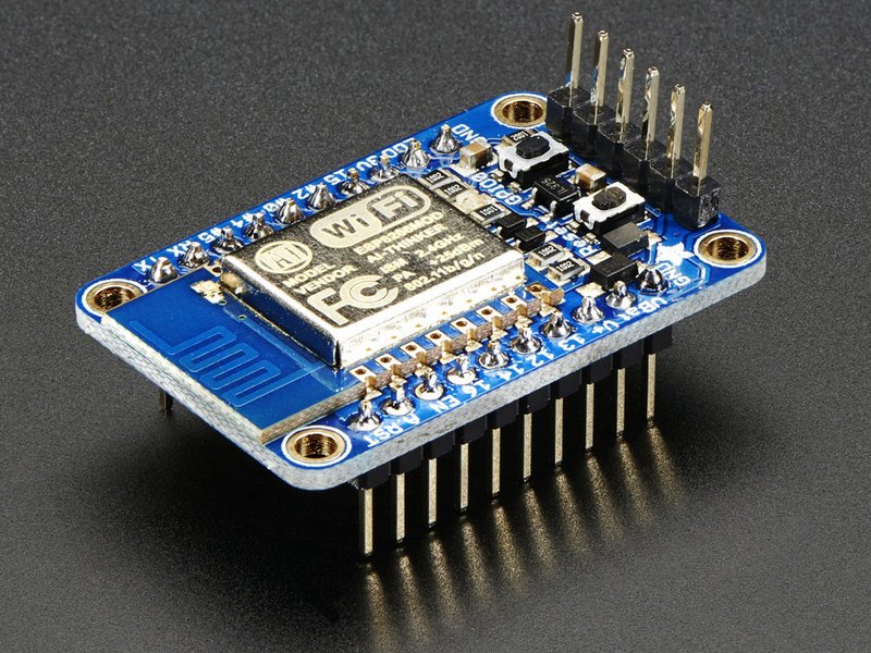

How did you solve the 3.3v/5v voltage translation from the Esp8266 to the LEDS?
Thank you for this code, helps a lot!
@Justin_Onimus same as with Teensy: no level shifter needed
I used the Huzzah because it comes with a 3.3V voltage regulator on board.
If you use a standard ESP8266 module you have to add a voltage regulator yourself such as LM1117.

Just to clarify: this is to use with the ESP8266 Arduino core (using something like Adafruit’s Huzzah or SparkFun’s “ESP8266 Thing” as an Arduino board, programming the board through the Arduino Software).

@Juergen_Bruegl When you select the new animation via the access web page, how long is the delay between the board running the new animation code?
@Jon_Burroughs Hmmm, just a short blink ??? (I’m old school and have a 30 year old Omega, hahaha)

@Tim_Field that’s why I made two versions. The Webserver is set up for your home environment: no switching to a new wifi.
The Access Point is if you are on a show and even want visitors to interact with your setup. In this case I will print a sign with
the Access Point name and a QR-code for the http
http://goqr.me/
