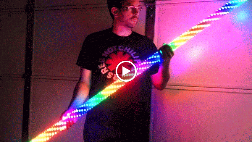

ESP8266-driven WS2812B LED staff! Four independent strips each directly powered with a an 18650 cell (nominal 3.7V), controlled with a NodeMCU clone running the ESP8266 port of FastLED.
Wow, excellent project. Looks super!
Looks amazing. How long do you expect the battery to last?

I like your spiral better.
Would you mind sharing details on the plastic tube?
I will post code soon…the tube is 2" polycarb from Amazon. The batteries last hours but that is of course with a fraction of full brightness.
