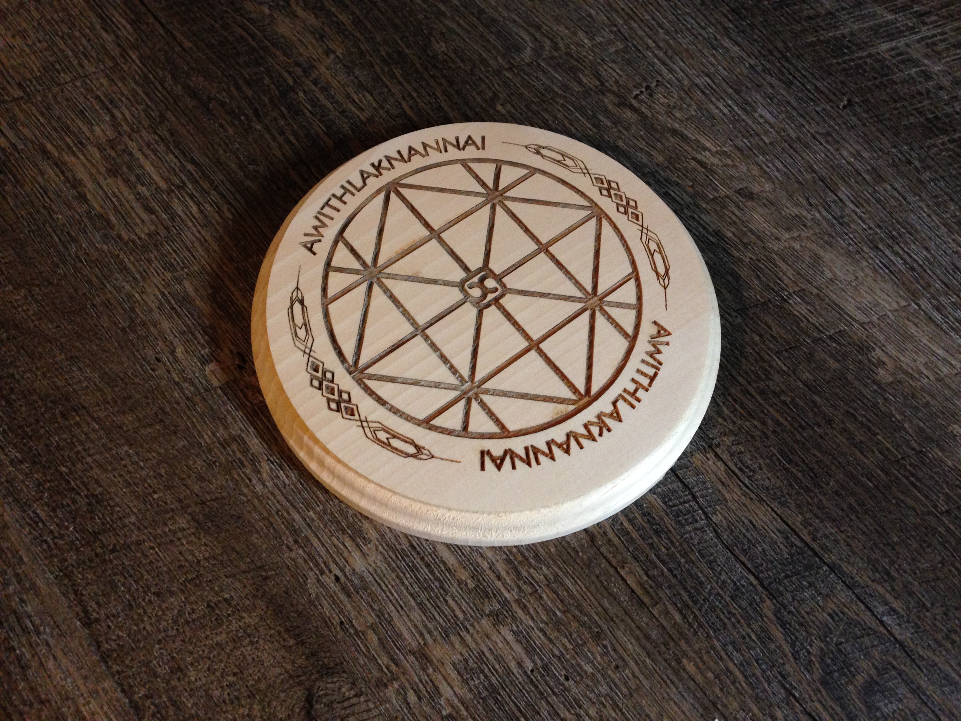

Etched a game board,
Etched a game board, but my eyeballing of the preview square was a little off. I need to get some rulers/guides in my laser area or something to be more precise about where I etch.
You’ll get the hang of it eventually. I have one main jig cut out of plywood that pushes up against the back wall & left rail. I’ve then cut out along the Refer-X = 0 & Refer-Y = 0 so that I’ve got an L shape. I then use secondary jigs that push up against the 0,0 point (on the main L-shaped jig) to align objects for the cutting/engraving. A simple method for the time being would be to lay masking tape along the entire bed & cut lines every 10mm or so on the X & Y axis. Then you’ll effectively have a grid to work off.
