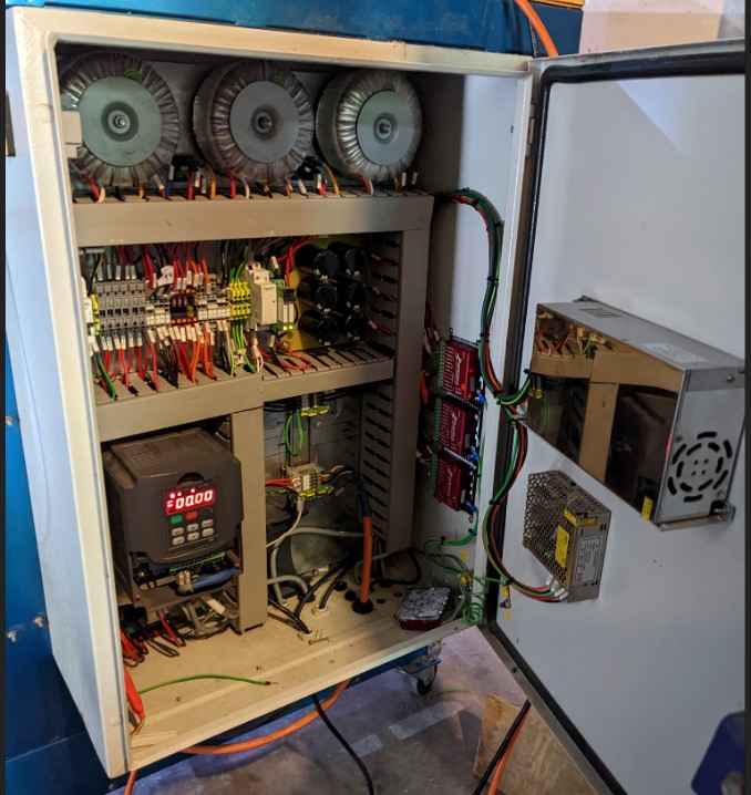

Can we see pictures of the setup?

Thank for the Reply Arthur, I am running 2 fridges in the workshop but nothing else. I will try turning them off while I run an air program to see how it goes. You think there is a spike when the fridge turns on?
My USB is already short cable and has ferrites. All my power cables to stepper motors and the Spindle are earthed at both ends and all control cable earthed at one end, to stop ground loops going into the controller.

One of my fridges is a fermenting fridge which has a heating and cooling cycle (eg PWM and SSR). I turned both fridges off and the mill ran without a hitch. We will see if it continues.
Both machines are on the same power supply and have as short a cables that are practical.
