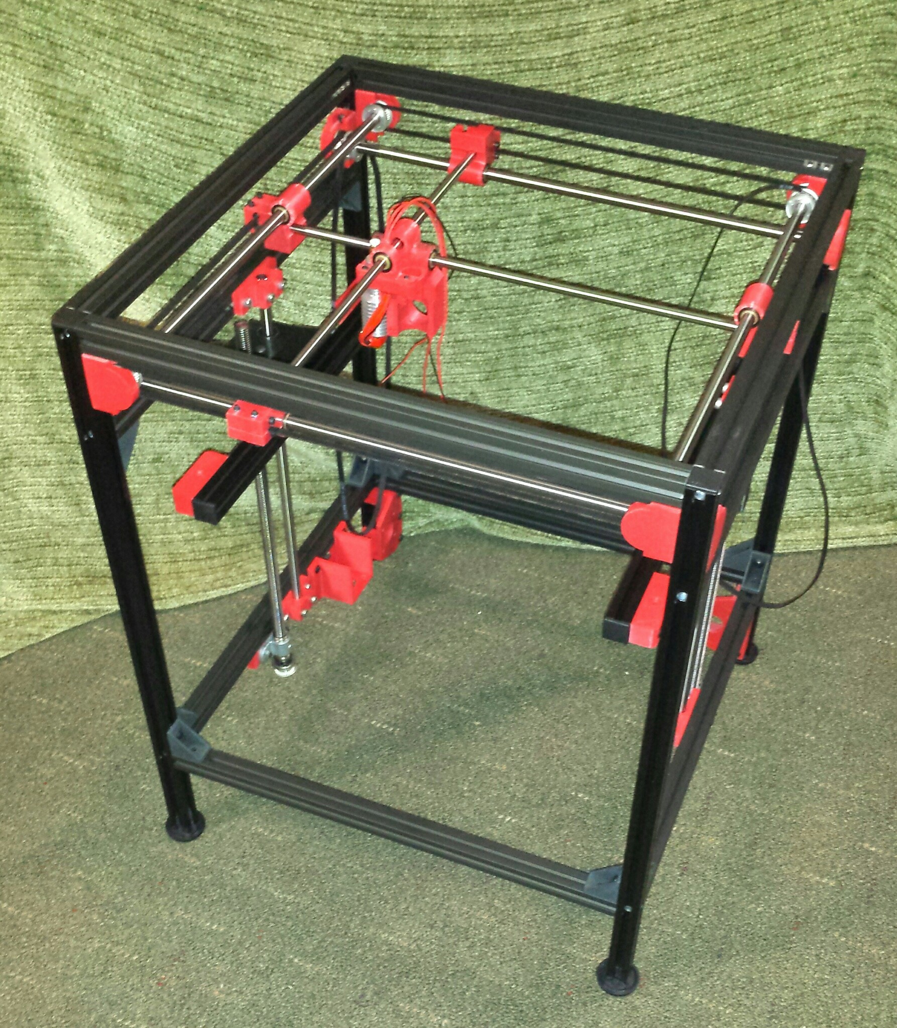

Are you willing to print a full set of plastic parts for your Lien3D Eustathios Spider? I would like to buy a set from you. I currently have a QU-BD Twoup but it just broke down and it's not repairable (Wooden chassis broke in multiple locations). I've been searching for another platform that I can reuse my parts from the Twoup and your's fits the bill. Can you contact me in regards to this? I'm sure your busy since your a family man (I have little cousins that keep me busy haha) but this help would be greatly appreciated. I can paypal you.
I will try, but I think the aluminum extrusions are out of my price affordability. I currently found 1.5x1.5 extrusions for really cheap. I beleive at $3.00 per 2 ft.
I am as fresh of a beginner as you can get. I’ve watched a lot of videos but am unable to create anything at the moment. What size extrusion are the files made for? I tried opening your files on github, but doe some reason I can’t. Not even your pdf file is viewable. Can you create a regular pdf file that does not require 3d? Your build is a 1 ft x 1ft correct?
@Gus_Montoya the PDF requires actual acrobat, not foxit or others. Freecad can open the step file, and sketch up is also in there. Plus you can get the rhino free trial for step.
