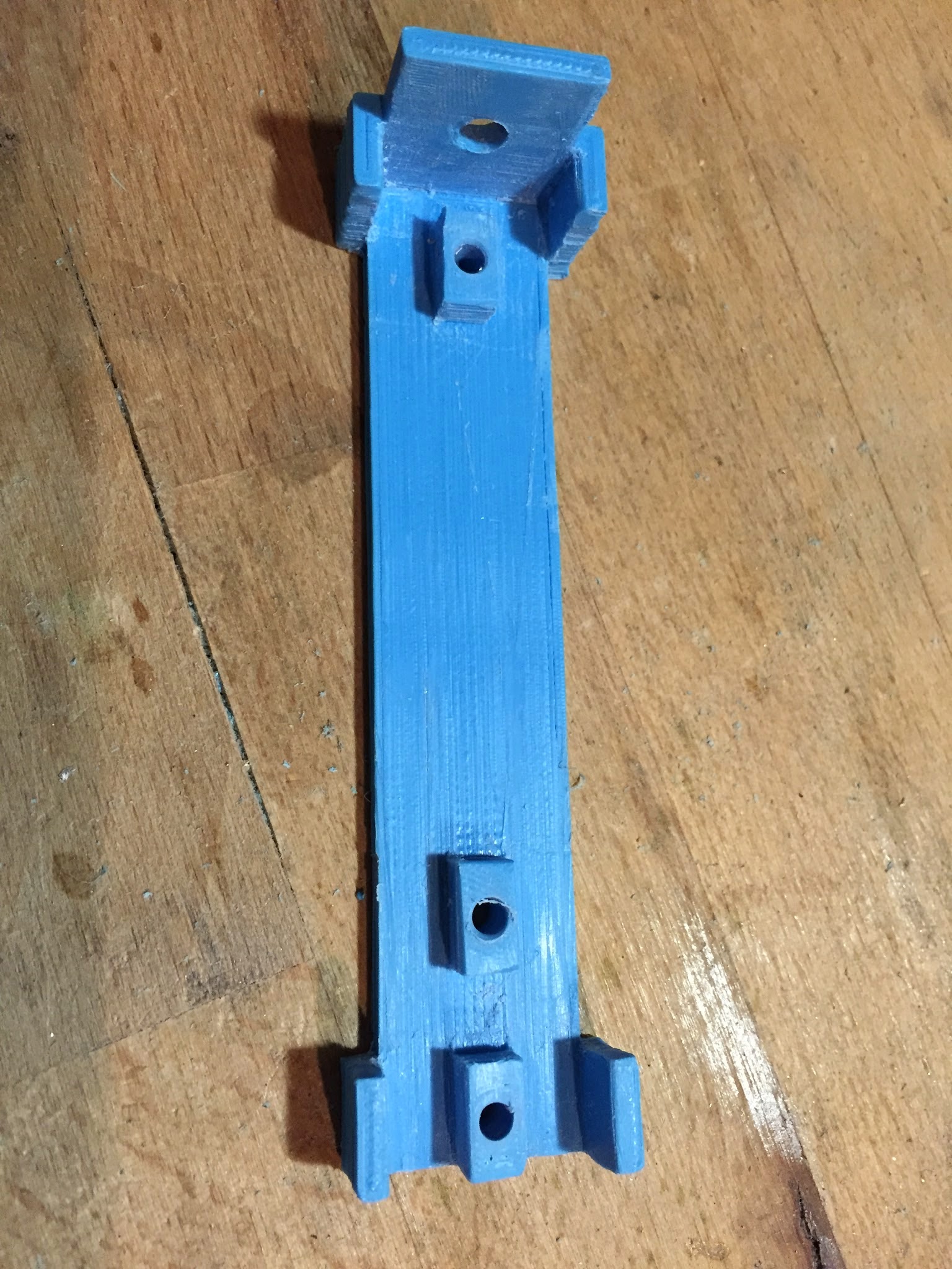

Started with my Eustathios build. Decided to build a mix between V1 and @Eclsnowman V2. Used the bearing holders with holes and longer shafts so I can add hand wheels for manual positioning. I built new stepper holders for X and Y that allow to use Robotdiggs gt2 976mm belts so there is only one size of closed loop belts. The steppers stay below the lower cross rails and hence fit under a cover. I also used a different ACME nut and built a holder that can be screwed to the Z axis bed support (had to change the distance between the holes to fix this holder). Leadscrew is 10mm ACME with 2mm pitch, 32T pulley can be directly mounted to it. I used 6009 bearings (10mm id, 22mm od) in the Z axis leadscrew support. Designed a little drilling template to drill the holes in the 2020 profile (fits for Motedis 6mm type B if anyone is interested)

Could you make your drilling template available? Looks to be a very useful part to start with!
yes of course, here a link: https://www.dropbox.com/l/aLWpJqJl8D534ySAnMkTnn
formats are autodesk, step and stl
please note that the distances from the top are 2mm more than in Erics Design as I don’t use the plasitc caps.
Distances are 10mm and 95mm from top (hole 1 and 3). 77mm for the bottom one (hole 2)
I use this profile: http://www.motedis.com/shop/images/product_images/popup_images/1_1.JPG
You might have to adapt the template if you use a different one
