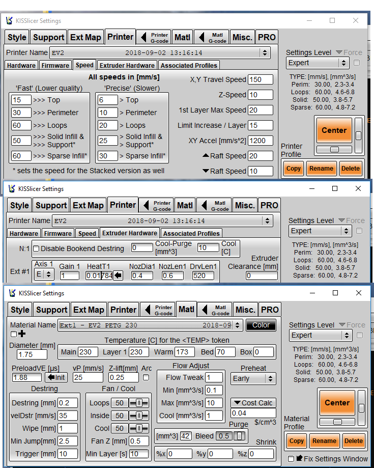

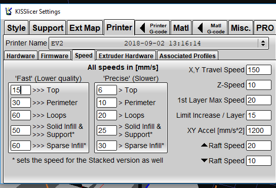

Eustathios folks- what kinds of speeds and feeds are you using ? These are my KISS settings for PETG and I feel while i get GREAT prints with them, I want to try speeding things up a bit.
What are your suggestions- how fast are you printing at?

How slow do you go for 1st later?
Do you use a slower speed for top layers to improve finish?

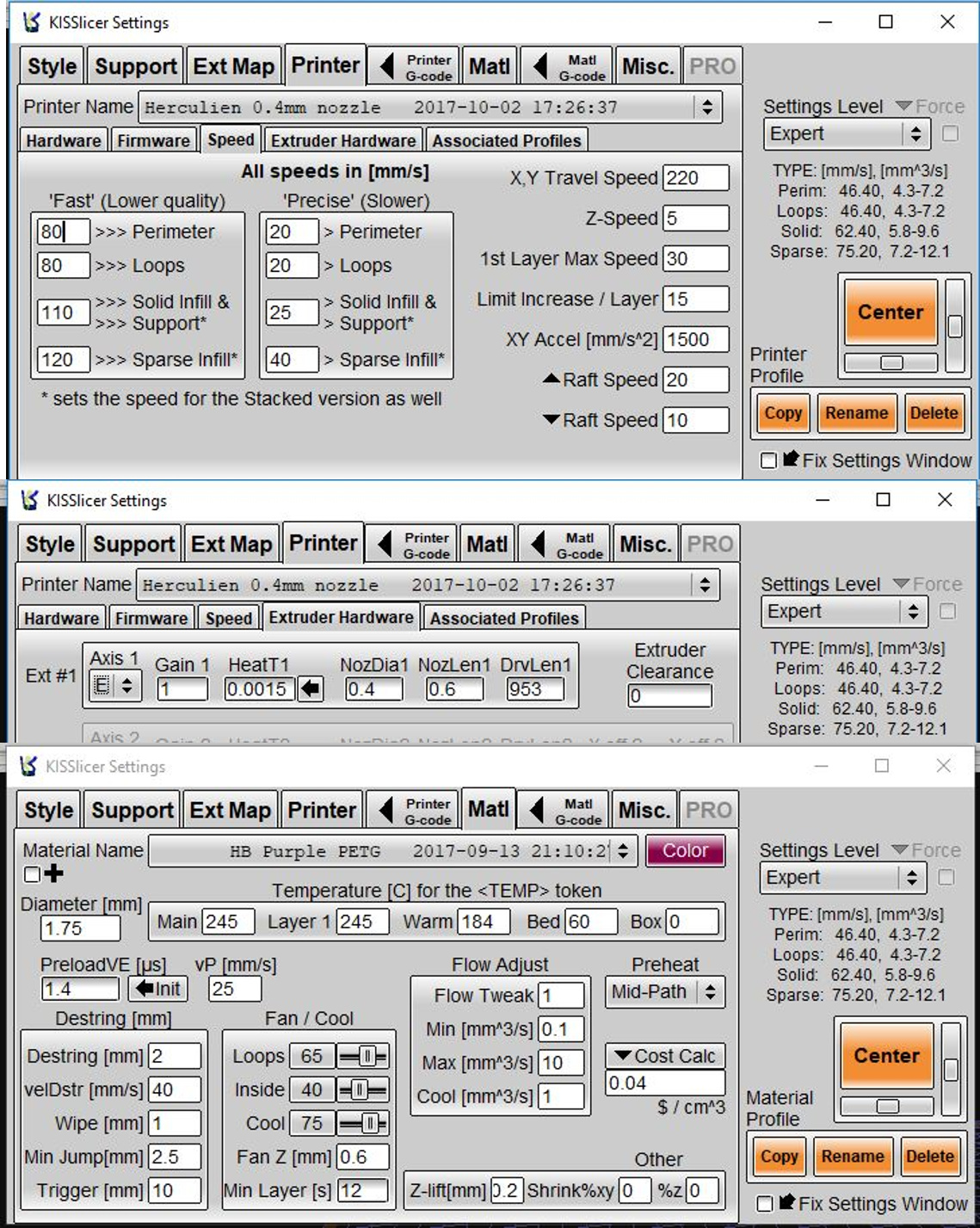

@Dennis_P I’m aware of and have used KISSlicer quite a bit in the past. Here are my relevant suggestions. I would also add M204 E3000 to your start g-code as a starting point.
@Zane_Baird thanks for posting that. It gives a broader sense of settings. I went through the tuning wizards starting with Temp all the way to destring and those are my results using Inland eSun silver PETG. Here are mine-
I am also realizing that I am probably hitting the limit of my hardware as I am on RAMPS/Mega and should not be too greedy. There are times when I think I have seen a hiccup or where I think the mechanics outrun the electronics. That is probably my biggest obstacle. I probably should pull the trigger on a 32bit board.
