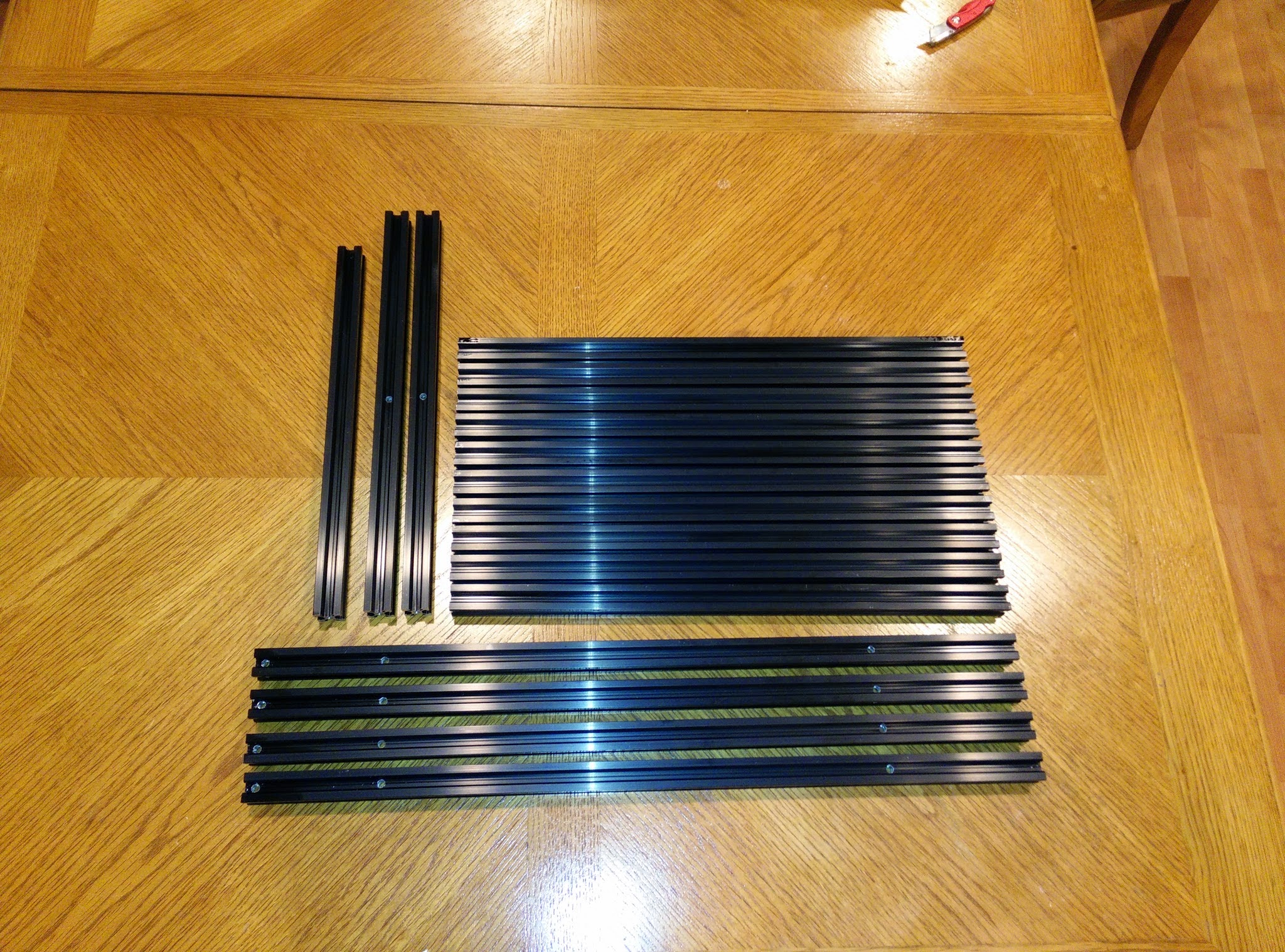

Eustathios frame arrived today. Building starts tomorrow
Did you order it pre-drilled & tapped?!? If so, what are the magic part numbers? I would have already done it if Misumi didn’t make it so difficult!
The part numbers listed in Jason’s BOM are predrilled. But if you want screw on feet you need to tap them. You can also print some feet that slide over the extrusion.
These are actually vslot (OpenBuilds) extrusions. A friend of mine did the cutting, tapping, drilling for me with precision and accuracy. I’m very happy.
@Alex_Lee that’s the kitchen table!!

I’ll do my best to gather photos of the build. I’m going to have to use the t-nuts from OpenBuilds for this. The t-nuts and post install t-nuts I intended to use are still in China :(. I’m going to have to pre-load the extrusions and pray I don’t miss one.
