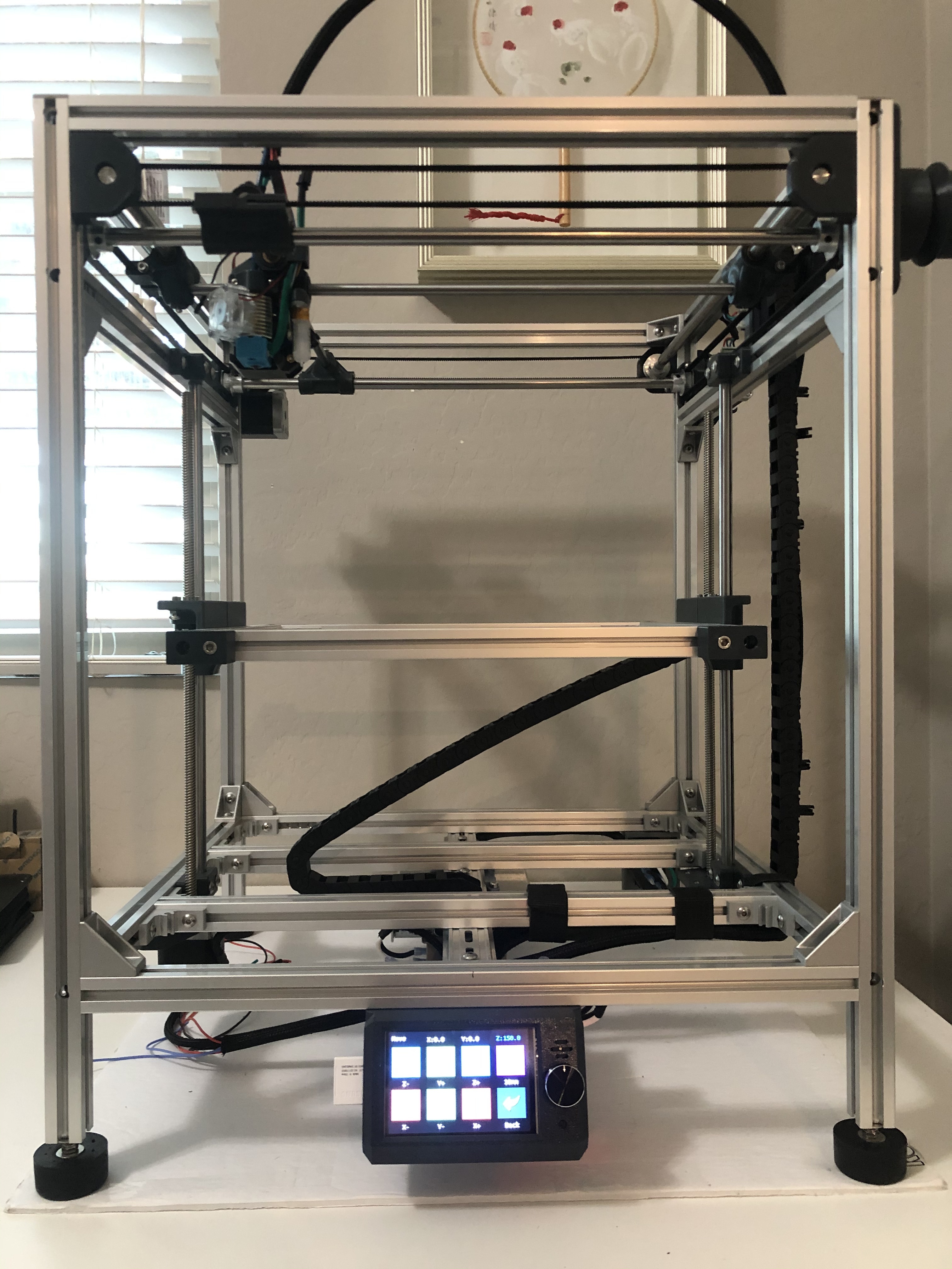

I hope you all had a safe and Happy Thanksgiving here in the USA. I made a lot of progress this week with the electronics. I have almost all the electronics mounted and wired up. I still have work to do on build plate so I can’t mount the heat pad and bed thermistor yet. I got Marlin running on the SKR 1.4 Turbo board using Eric’s config as a base. I had to tweak it a bit since I am trying out sensorless homing. Anyway, so far I tested all the steppers and they are working. My X and Y is inverted so I think I need to tweak Marlin to correct that. Hotend is also starting up great. It was great to see the printer have movement! I can’t wait to get the bed on there so I can finalize all the tests and configuration and perform the first print. Updated photos are attached!
Question for @Eclsnowman, is there a gantry break-in GCODE you recommend for the Eustathios?
Oh man. I love the din rail electrical setup. So clean.
For the breakin gcode, you can use the one for Eustathios V2. It could be tweaked slightly for V2.5 since the travel area is greater on 2.5… but it will certainly get the job done.
Thanks Eric! It turned out a lot better than I thought it would. I’m getting there!
Wow, that is looking very nice, very clean - well done!
Thanks Bruce!

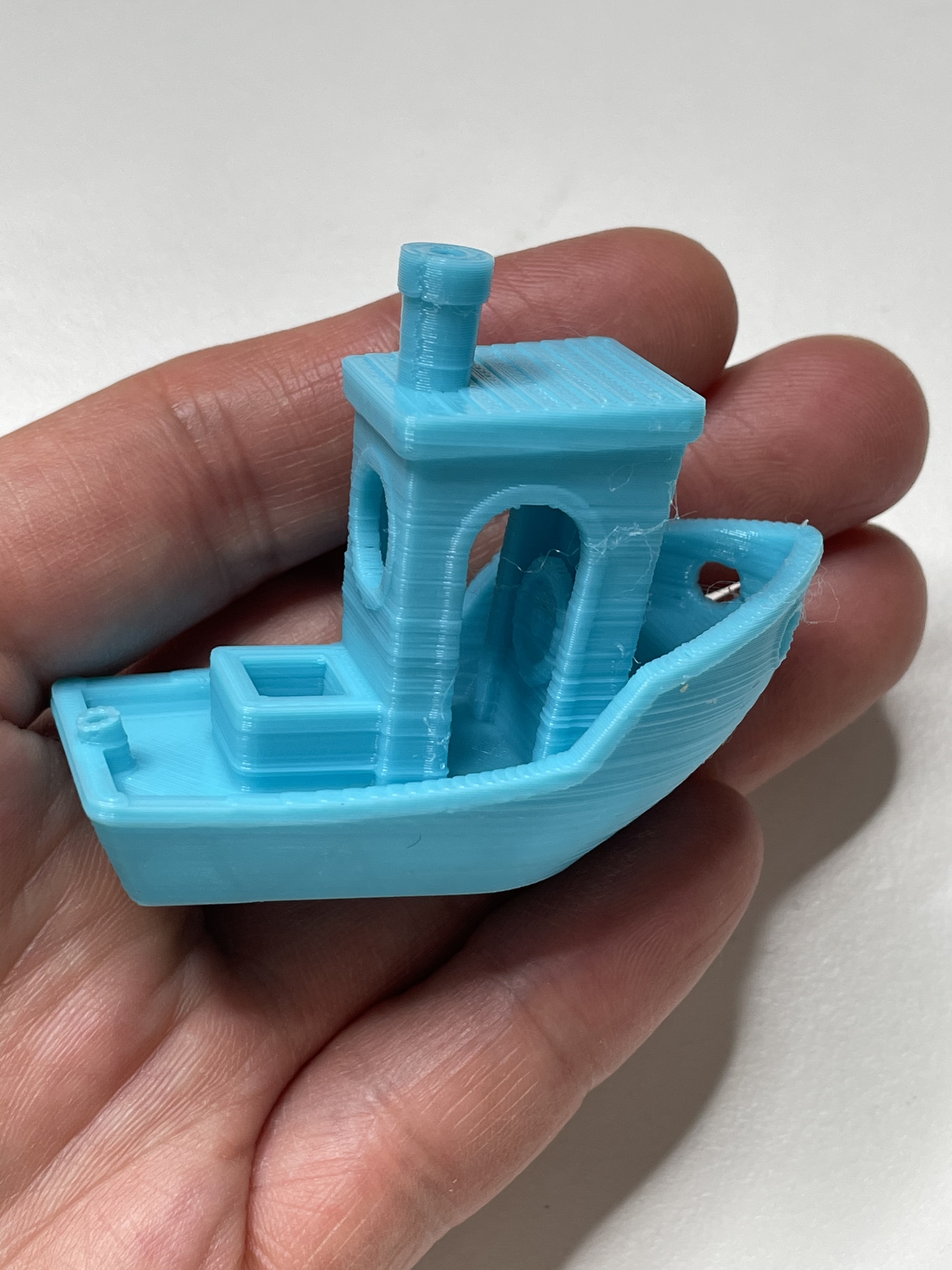

After a week of leveling the bed, modifying firmware and printing calibration models I finally attempted a Benchy on my printer. Far from perfect and needs more tuning or fixing.
I’ve had a hell of a time trying to physically level the bed. It almost seems warped a bit. I got it as close as I could in hopes that ABL can compensate for the rest. Has anyone tried UBL instead of bilinear? The Z banding has me worried that my z axis is messed up a bit.
Looks like binding, and maybe some of over extrusion. If you disconnect the z motors leadnut from the side supports and spin them down to get them out of the way, does the bed move up and down smoothly by hand without binding?
Thanks Eric! I think you’re on to something with the binding. I took your advice and disconnected the z motors and manually moved the bed. I can feel some binding at the top of the bed movement but feels smooth elsewhere. I loosened the top Z axis rod bracket and it settled a bit off center of the frame. I am sure my frame is square so I’m a bit concerned that z movement won’t be squared with the frame if I leave it where it’s resting. I might just tighten it up and see how it prints. Open to other ideas if you have them!
