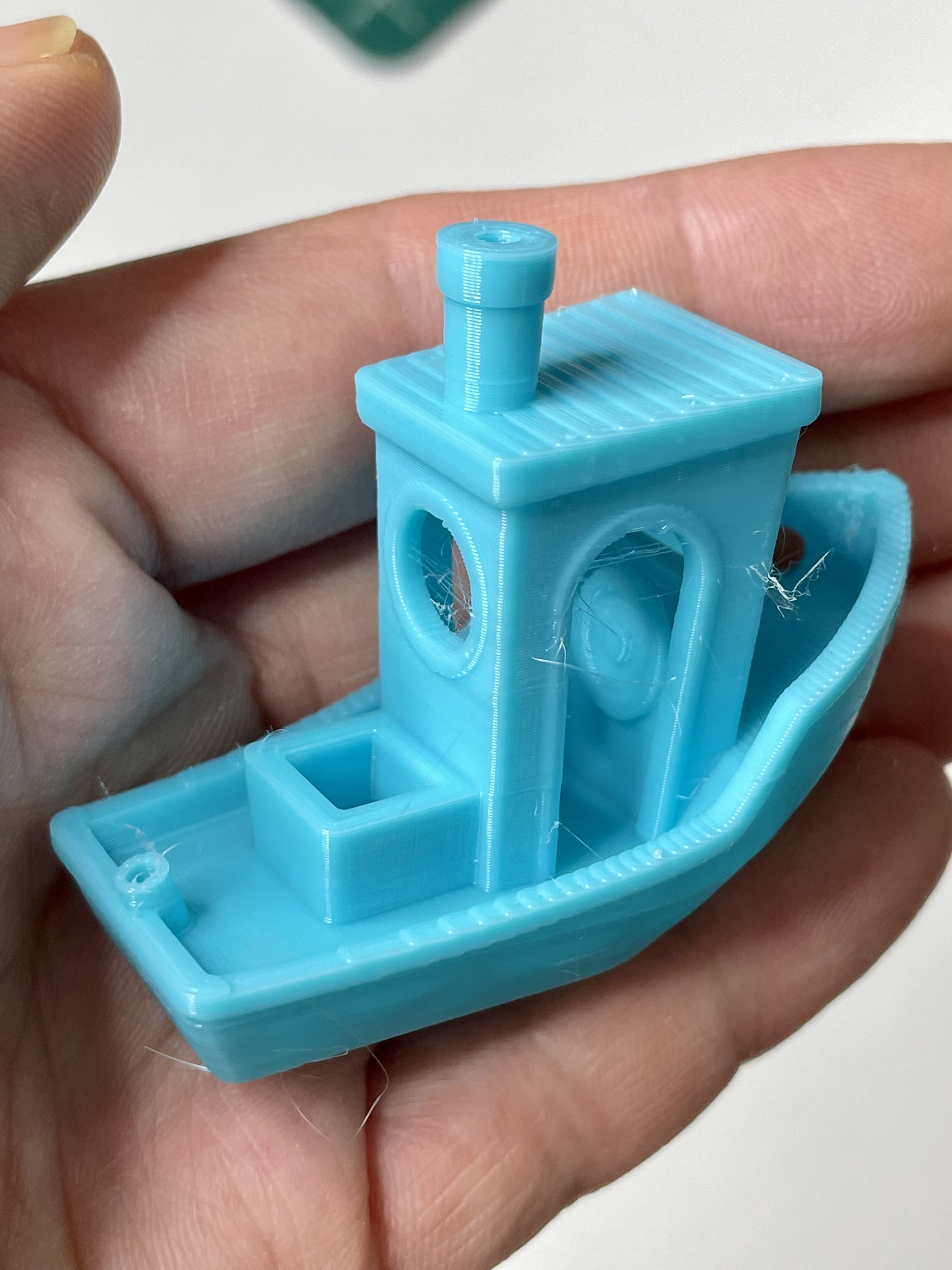

I spent the last week rebuilding the gantry and Z-axis on my printer. I found a few areas where there was some binding and fixed those as best as I could. The Z-axis was tricky to clear up and I don’t think I have it perfect but close enough to see if there are any improvements. I’m please to say that it has!
I think I still have some slight over extrusion going on but I’m feeling better about the axis’s being straight now. Thanks for pointing me in the right direction with troubleshooting it @Eclsnowman !
I’m going to run some more calibrations on it and then try printing PETG.
It’s looking great, a little more tuning on temperatures and retractions and you’ll be there. I think I agree with you that I would dial extrusion back a little bit more. Really it comes down to whether you want the part to be more visually appealing or more structurally sound. On parts where I want a lot of strength I won’t dial back the extrusion quite so much because the extra plastic just adds to the strength. But when I want to have a part look visibly better I’ll run the extrusion multiplier down around .92-.93 and I found the parts tend to look a lot better. When I reviewed some of the slicer settings of people online who have very pretty looking prints it’s almost always that they’re running narrow extrusion widths and slightly under extrude. It makes for pretty looking prints.

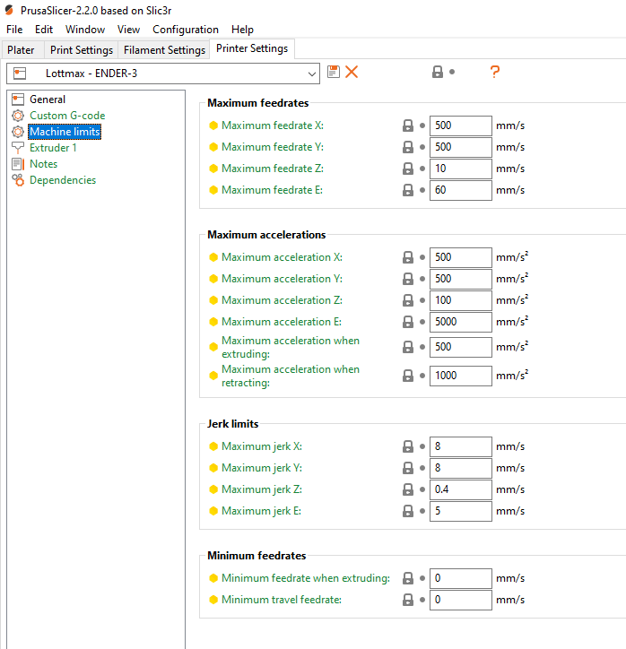

Another thing to double-check is depending upon what slicer you’re running, sometimes the slicer will overwrite these mcode values in the start g code. Prusa slicer tends to do this if you have the G-Code flavor under printer settings set that way:
