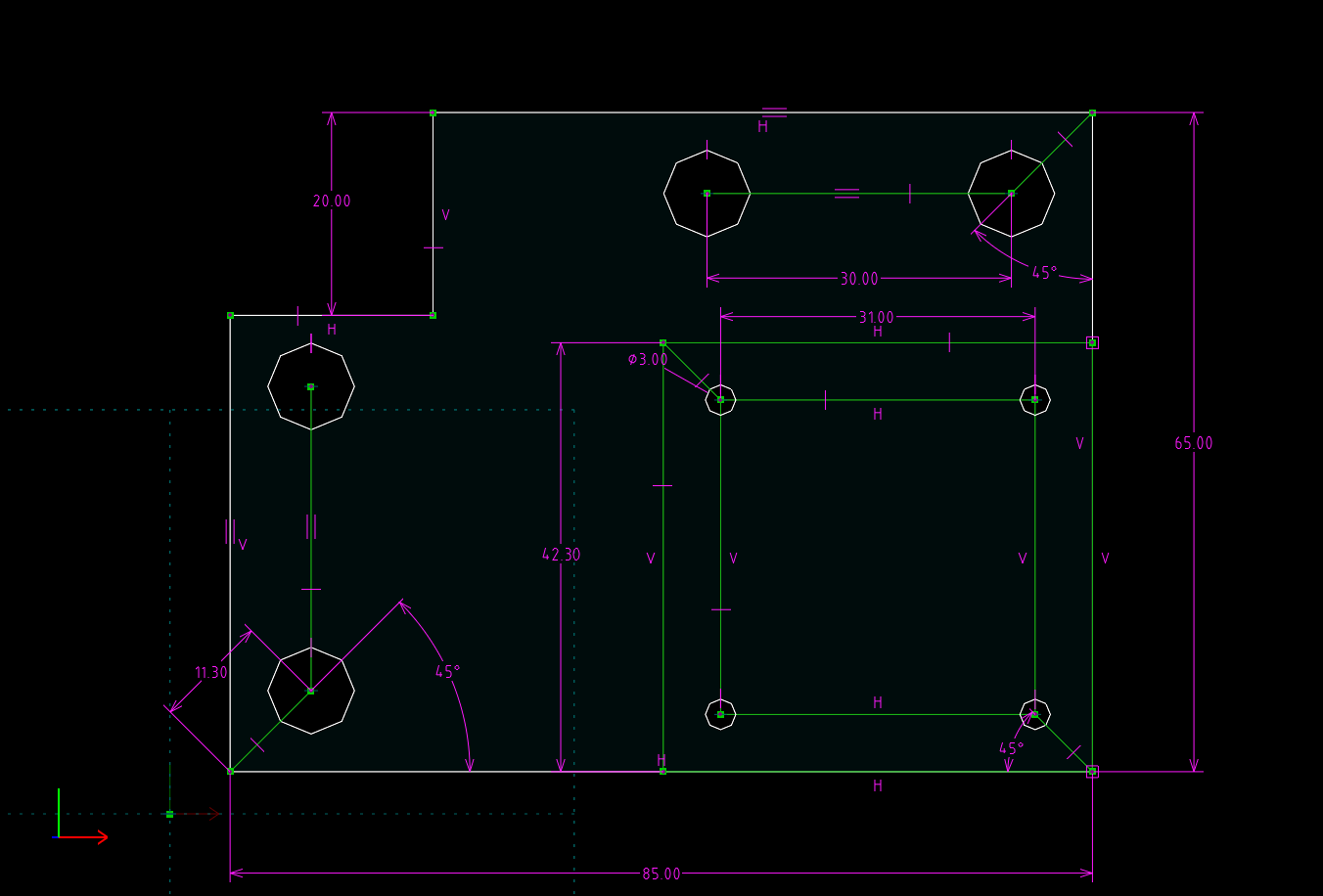

Evaluating Solvespace for my 3d designs. The interface looks archaic but the program works very smooth so far. Solvespace is a parametric CAD program much like FreeCAD but is much more lightweight and probably more stable than FreeCAD.
I’ve been using it for lasercutting. Excellent program. Limited for detailed 3d work due to lack of fillets/chamfers/lofts etc. But its simplicity makes up a lot for its feature set.

And if I understand the developers correctly these won’t be implemented any time soon. For many of my projects however I can work around these limitations.
@Luis_Diaz
I will, but my preliminary thoughts are that the constraint solver is excellent and assembly is, compared to FreeCAD, really easy.
True @Eric_Buijs , it would apparently require a very heavy rewrite of some parts. (If I understood correctly).
