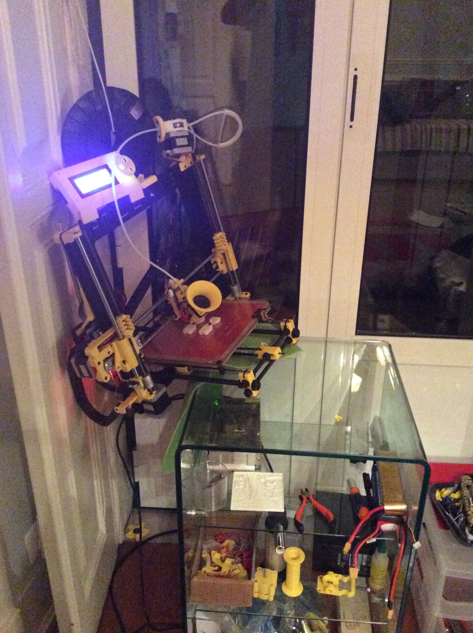

Evasion attempt, helped by a stuck roll and the saint… Torkey enough?
#saintflint
… Forgot to explain the roll was attached to the door on the left!
You have big lucky as last…lock your prusa
Shauki…this a confirm to print the saint
@Michael_Memeteau think #saintflint are good in PLA too?
Yes, it was printed in PLA (I like the stiffness and printability of it). 0.2 with 0.4 nozzle, 2 shells & 20% infill (using Kisslicer). No need to change e/steps compared to Flintstruder (which is a good thing since it would mean slippage). In my case: 166,67 step/mm. Also discovered that having the loop on the thread side is much better: this you don’t forget to put the ring or put it on the wrong side and the loading is way easier! Just adding a finishing touch: some openings to help releasing the screw that hold the PTFE line for dismounting and more cosmetic change.
