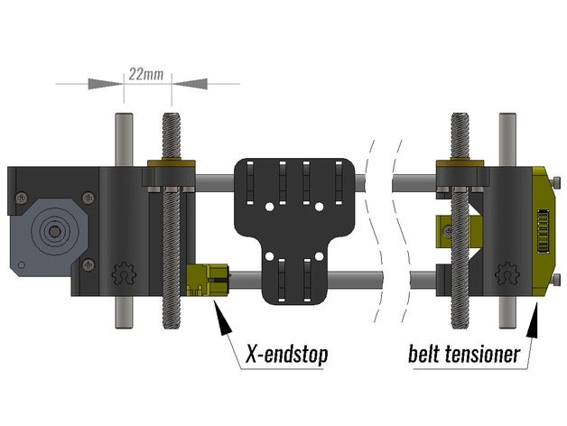

Do you know which thingiverse items you printed for the tr8?
I printed this: https://www.thingiverse.com/thing:1572575 and the remixed motor one which removes the indent at the bottom.
@raykholo
I printed these (21mm version), but reused the toolson x endstop
