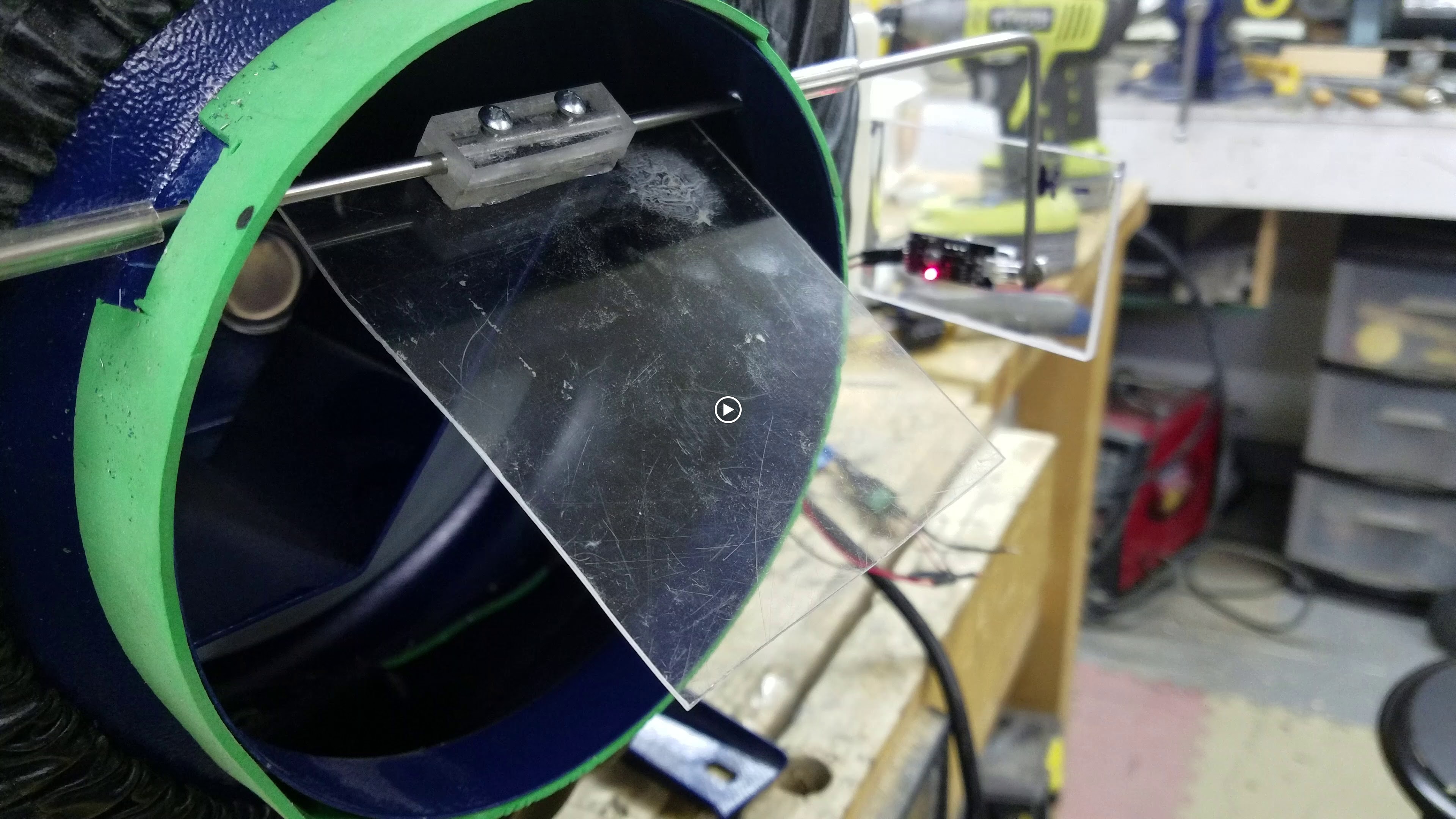

While working on my K40 I thought the fan was running and it was not. Its pretty quiet and down below the machine. Turns out I had a problem with an AC connector.
I set off to design a sensor and this is what the results were …
… ya it got out of control!

@Steve_Clark no kidding… Btw wanted to use a microswitch but it took to much force and to big a sail. So went to hall effect. Side benefit is you can see the amount of air by the lever position lol.
