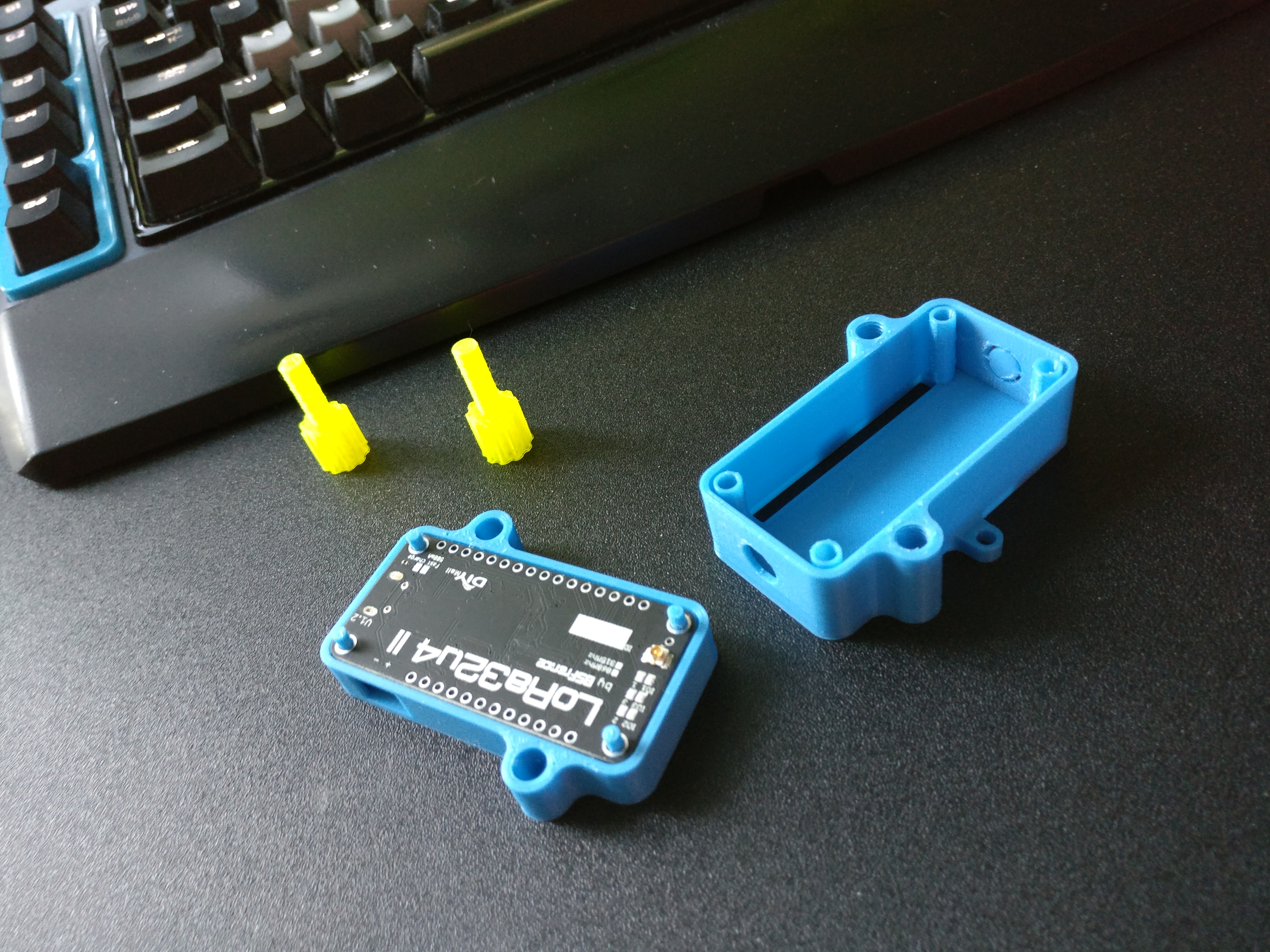

Ever since I moved to the new house, I’ve been getting a lot more use out of my 3D-printer; it’s easier to access and its noise disturbs me a lot less, now. I’ve also come to the conclusion that I find it more pleasing to practice my skills in Fusion 360 and print functional items instead of decorational items or toys – I am a complete noob, still, when it comes to Fusion, but perhaps I’ll master it one day.
These pictures are of my latest creation, a case for the Lora32u4 II - devboard. It didn’t quite come out as pretty as in the renders, but it works well, nevertheless. Oh, and yes, 3D-printed threads work perfectly and make for very pretty, custom screws and nuts :slight_smile:
Those are really nice-looking! What are you printing with, PLA?
My primary use case for the 3d printer is fixtures, enclosures, and adapters.
@John_Bump Yeah, PLA for stuff like this, which won’t be subjected to a lot of physical stress or such.
I do try to do everything in PLA because it’s biodegradable, but if something is going to be subjected to more punishment than PLA can take, I’ll switch to PETG instead – it’s a tad bit more stringy, leaving a kind of unclean look to it, but otherwise PETG works just as well for threads and everything.

@Geoffrey_Forest Well, it’s not like I can take the credit for the threads, Fusion 360 makes it so ridiculously easy to make them: 1) make a hole or a cylinder 2) point the thread-tool at it 3) check the “Modeled” checkbox in the dialog that pops up 4) click OK – boom, you’ve got by-default ISO-compliant threads! Hard to make it much easier than that.

Nice, which pla are the blue, yellow and pink?
@Brad_Hill They are all Primaselect PLA from 3D Prima. Their filament ain’t exactly cheapest, but it’s really good quality.
