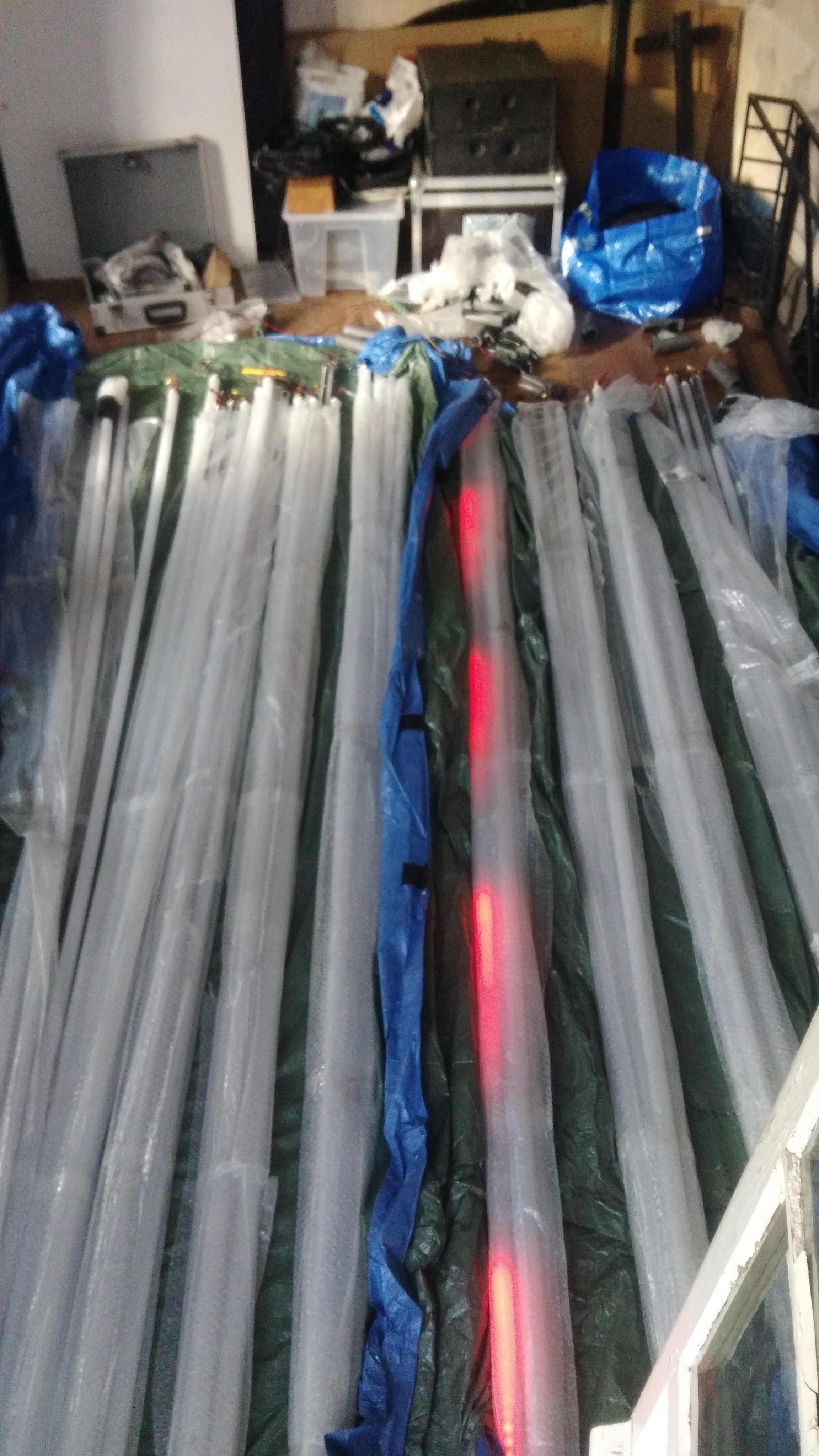

Every things working! Good start for a new led show …
Do you build the diffused tubes or have them produced? Love the ease and utility in this form.
@Tom_Schubert Home build absolutely, that was a challenge
@Derrick_Giscloux are they ~.75" frosted acrylic tubing? They look very clean in your installation photos
Whoa !! That is impressive !!
How many tubes for how many leds ?
@Yves_BAZIN fourty tubes / 3 meters long / 60 WS2812 per strand
lot of work …
@Tom_Schubert No it is PMMA that is stronger than acrylic and diffuse fx is good
So cool. Where did you get the PMMA tubing?
