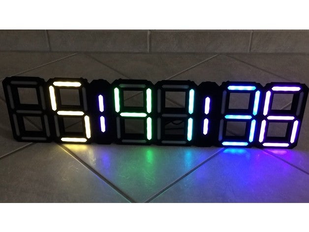

Every time I look around in this group I feel the need to build something with lots of leds… there’s so many nice things and ideas to see here :smiley:
So this weekend I did a rework of a 7 segment clock I did a few months back. I will upload all the files to Thingiverse later including source code. Took a while to figure out some parts but I think it’s hard to beat how easy and fast it is to build… :slight_smile:
Here we go: https://www.thingiverse.com/thing:3014572
All STL files and Arduino code (using FastLED/DS3231RTC/WS2812B) can be found there.

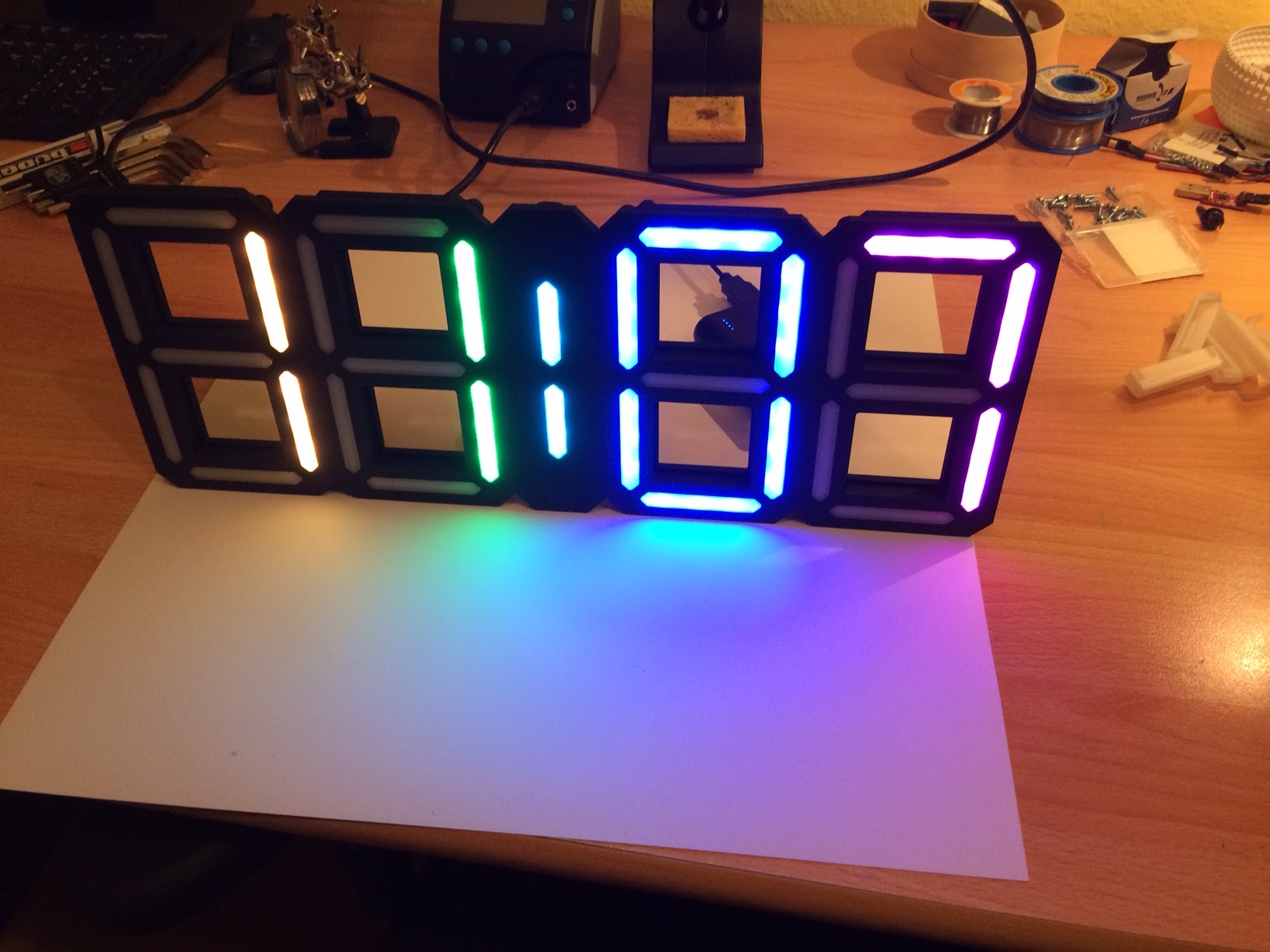

About the clock: When using it for own projects the addition I just made might be welcome:
This will add a 3rd module to the clock. But you can add more modules if you like to.
