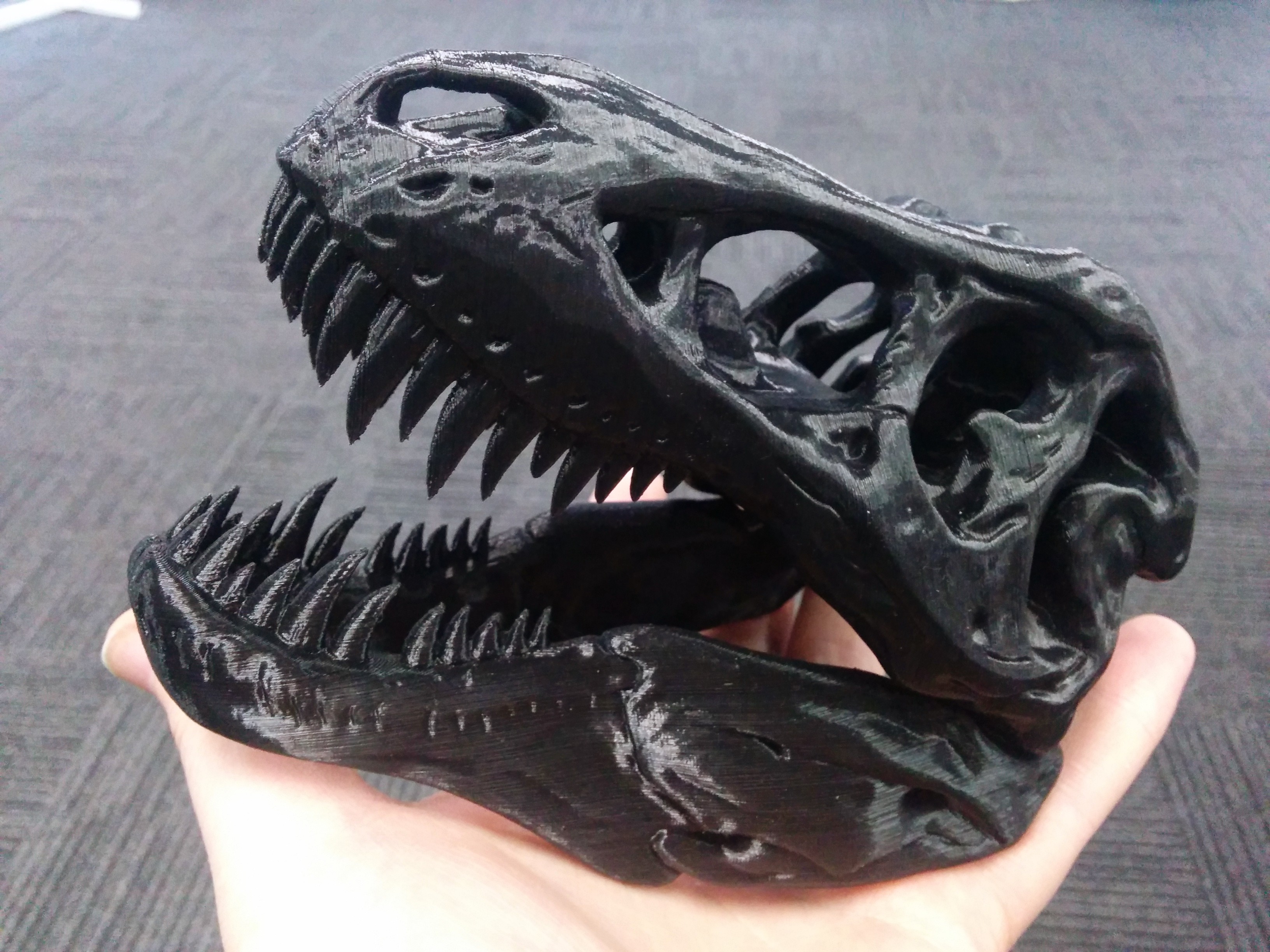

Everyone’s current favorite the T-Rex skull.
Diamond Age PLA
0.15mm layers perimeters
0.3mm stacked infill (first time testing this, worked perfectly)
90mm/s
@Maker_s_Tool_Works MM2.0 printer
Slice with KissSlicer
No Raft or Support used.
Diamond Age PLA
90mm/s
I like it in black. Reminds me of the La Brea tar pits in Orange County.
@Rojer_Wisner Hmm I hadn’t thought of that, cool.
Though I do have some white, I just though the black would look better, plus the white really makes any print flaws stand out, the black is a lot more forgiving.
how long it took?
@Enkhamgalan_Nasanjar I printed both parts in less than a day, but I didn’t really note the time and there was a few hours between printing the 2 parts, at a guess 10-12 hrs.
Wow no support? I am looking at the layer direction of the prints… That would be some crazy overhang unless I am not envisioning it correctly. Mind showing a picture of where the parts were touching the build plate?
Is this vapor polished or just really high resolution
medium resolution, which is 0.2mm
@Mike_Kelly_Mike_Make I printed it, as in the post description
0.15mm resolution. That is as it came off the printer.
