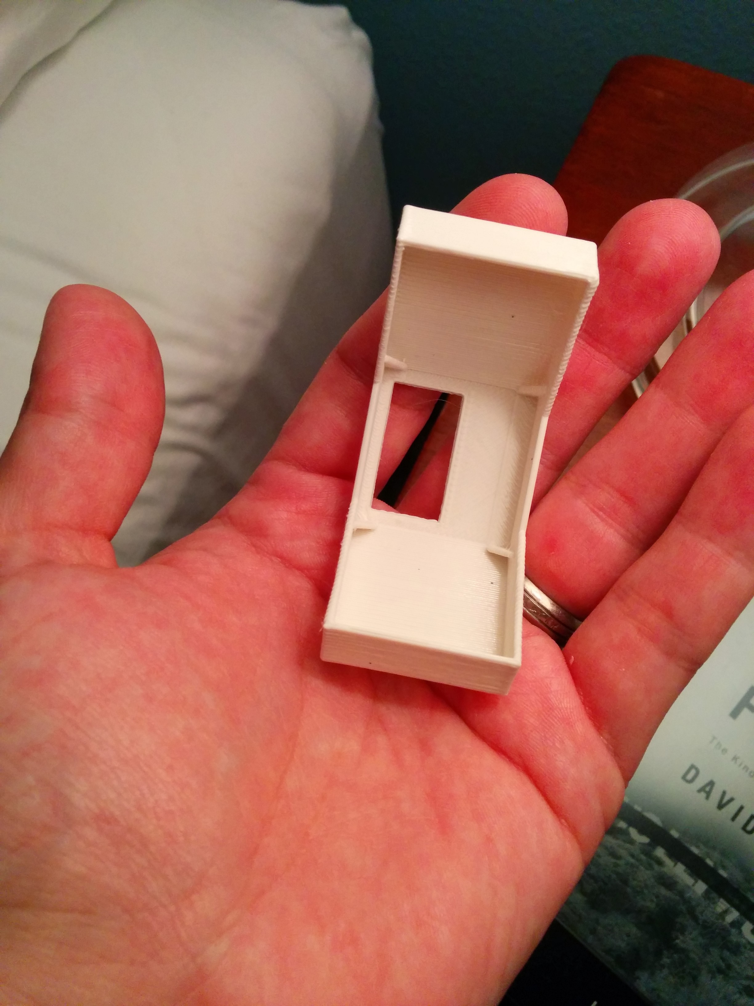

Evolution of a print. Working on a new prototype.
Working on a new prototype. Industrial design is hard!
You can see the progression. I started with the piece on its side but the bridging was too bad. Next I added internal vanes to add support. Better but still bad.
So I took a chance and printed it on its back. Not bad, though at 60° from vertical its still too steep. You can see some print errors. So I changed the model to 45° . Much Much better.
which printer are you using?
PrinterBot Simple
nice, whats did you use to make the design?
OpenSCAD. I don’t really know what doing but it sure is fun.

very fine, please, let me know, what was the surface being upon the bed?
Blue painters tape in a plywood bed.
