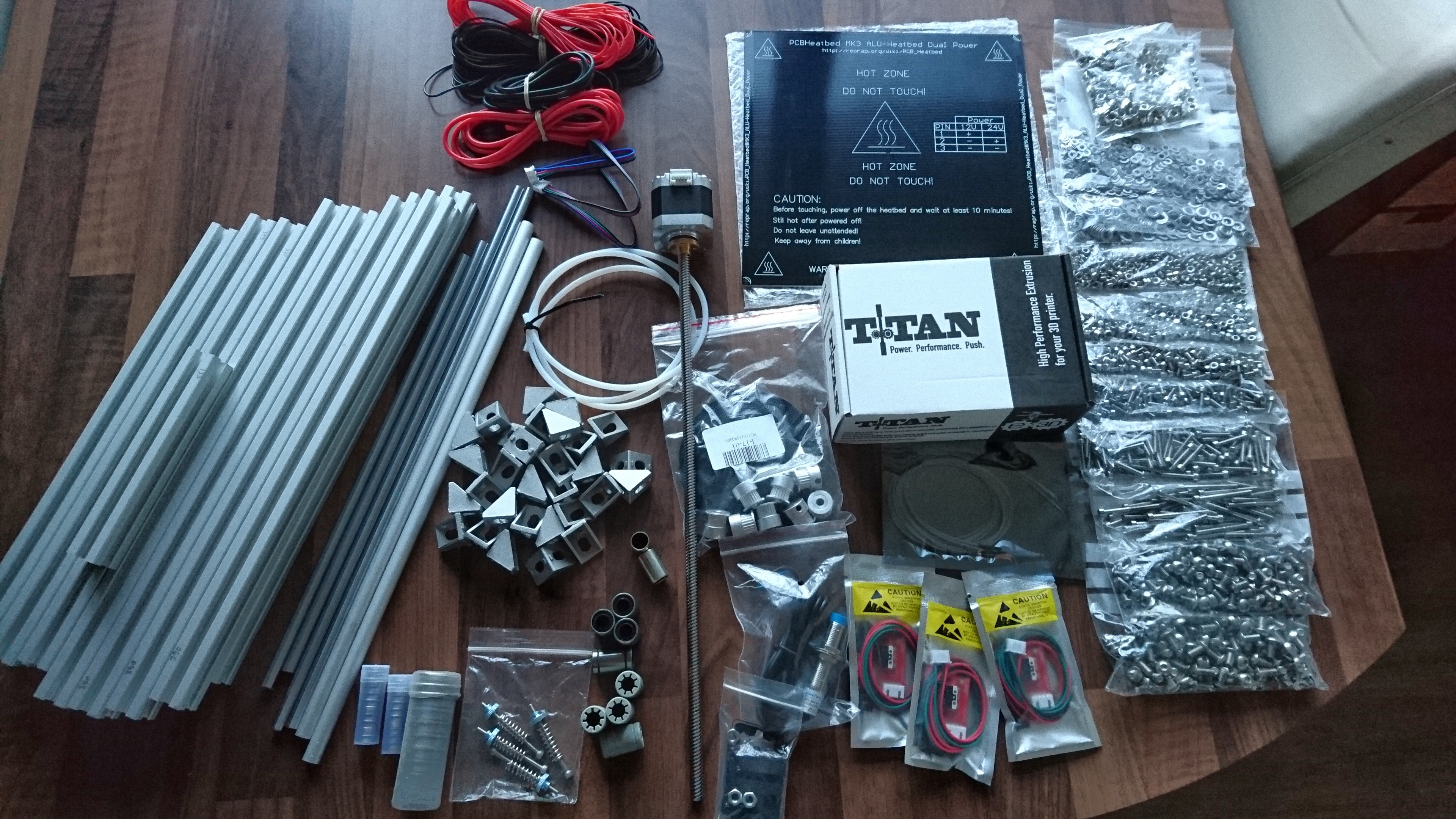

Exciting times, the post man has been! I'm building a Hypercube http://www.thingiverse.com/thing:1752766
I’m building a Hypercube http://www.thingiverse.com/thing:1752766

@Jason_McMullan ha I have no idea the total cost I’ve not worked it out. The cost of the frame was about £50 for the 2020 aluminium extrusion cut to length for me. What I have been waiting for are the corner brackets and t nuts. I had to order these from china as for some reasons they are silly prices in the U.K. And they were around £16. The steel rails were also from china just a few £ but they are very slightly bent. So I will probably order some precision shafts from these guys http://www.strongbar.co.uk/ just waiting for the quote.

@Emanuele_Melzi nice would love to see some photos of your build if you have any. I’ve been putting the frame together today. I’ll post some more photos here when I’ve done a bit more. Mainly waiting on the printed parts to finish now.
