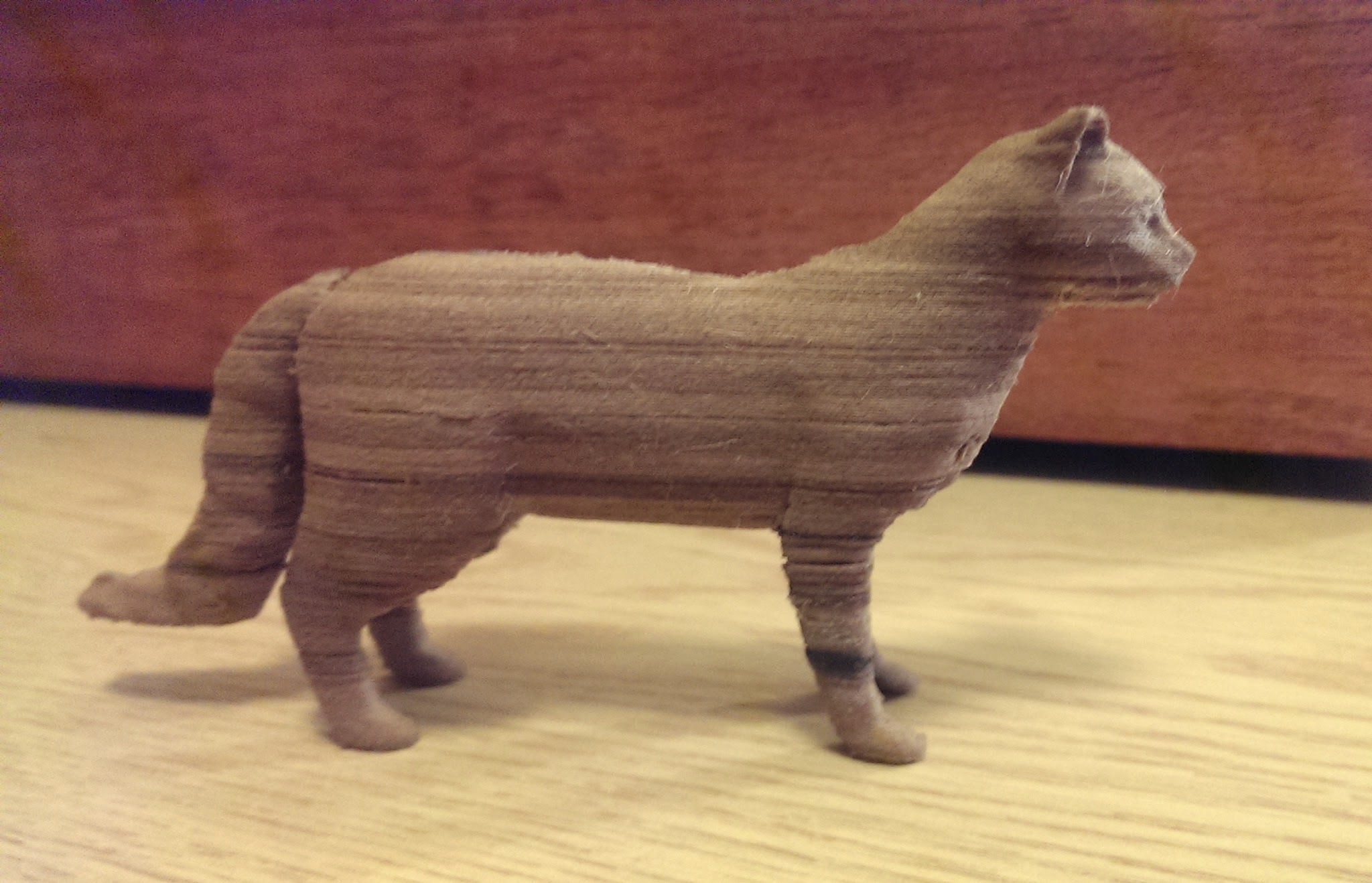

I’ve just been playing with Laywood and I thought I’d share my what I found as there doesn’t seem to be a lot of real world experience type information about it on the net. The photos show one of my prints of http://www.thingiverse.com/thing:1283 at 1.25 scale. It stands about 5.5cm to the top of the back, 7cm to the tip of the ears)

One thing is for certain, considering its 3D printed, Laywood is a pretty good approximation of the real thing. I noticed I needed to print a few perimeter loops (3 or more) to make it hard like wood but other than that not only does it look like wood but it even smells like it. The addition of tree rings by varying the temperature with the use of either one of the slicer plugins or the standalone python script ( http://www.tridimake.com/2012/10/shades-of-brown-with-wood-filament-via.html - shown here) makes it even more realistic. (Without the rings it looks a bit like MDF but not quite).
I’ve also done some experimentation with sanding down and wax/varnishing a couple of test prints. At that point it really starts to get hard to tell if its real wood or not, depending on your skill you could easily fool people I think. A quick word of advice for those of you thinking of sanding down your prints, when you do go easy with the paper and practice on some failed prints first. The reason being is if you sand too fast it heats the material up which unsurprisingly starts to melt and you get a horrid mess. You really don’t want to see my first attempts with a Dremel :wink:

There is one gotcha though which I found particularly frustrating on this particular model. The tree rings effect whilst spectacular requires you to vary the temperature quite dramatically. In the photos below this is effect is achieved by varying between 190c and 240c. Those of you with experience will know that this will have a dramatic effect on the strength of a print and laywood is no exception. The darker rings appeared to pose significant weak points and whilst the body was large enough to be solid and unaffected the feet were extremely fragile at these points. As you can see the front right leg broke off and I had to use a small torch to melt it back on again for the photo.

Hi @Daniel_Bull , I’m the one who wrote the tree-ring plugin. Actually I found the opposite effect regarding solidity. For me it tends to fail more often in the white bands, because the temperature is lower and it makes extrusion more likely to fail (ie. less material + less welding).
Proper bounds are hard to set properly when a drastic effect is expected, mostly because it depends on the printer & nozzle as you say, but also because of the filament. Laywoo had a few revision before getting stable (Laywoo D3), and there is a more compact “cherry wood” variant. It did not test the one from colorfabb (woodfill), but I guess it also has its own settings.
Finally, I was able to get some rings with some “regular” PLA, but the result is far from stunning, not sure it is worth.
Thanks for your review btw!
Wow, thanks for the post Jeremie and also the great plugin/python script :slight_smile: For me it seemed to break just above the dark bands but it could well have been the change from high temp to the cold temp that did it, so you may be right! I struggled to work out exactly why it was breaking but what you say makes sense it could be under extrusion from being too cold. I’ll try upping the minimum temp and trying again. Thanks for the info :slight_smile:
@Daniel_Bull yep, most probably; unless you get high enough for cabonizing the filament, which is a terrible thing to experience (I made sure I did not test this!).
What’s sad is that I would love to go as low as ~180 for very light bands, but it becomes too much of a lottery… That’s also why I have added the “spikiness” factor in the last revision (it skews the distribution in favor to the cooler/lighter bands).
