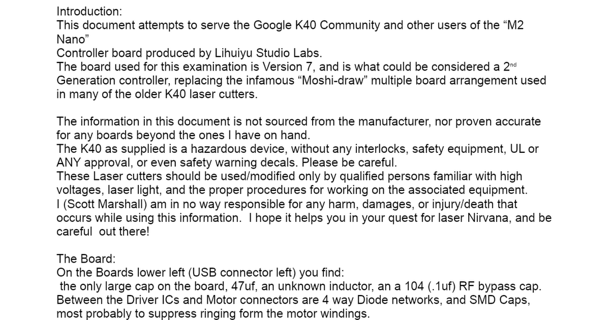

I was not sure where to post this info but thought because @Tatarize has done a great job explaining the M2nano board that this would compliment the information. It is actually a repost from Scott Marshall that is found in the G+ posts.
Did Scott pass away?? I wondered where he went :(?
Unfortunately that is the only conclusion. Years ago phone calls and emails went unanswered. His website went dark too.
Seems like good even if older information. I know the V4 version of the board had weirder stepper chips this data seems to suggest that it’s 4895 rather then 4988 like we find in the V9 version of the chip. The outline says it’s running V7 there.
The answer’s still generally no. But, I’m looking for a replacement stepper motor and some mostly compatible 1.8 deg one is really tempting. Then just rewrite the software to allow variable x and y. Needs some things like anyway.
