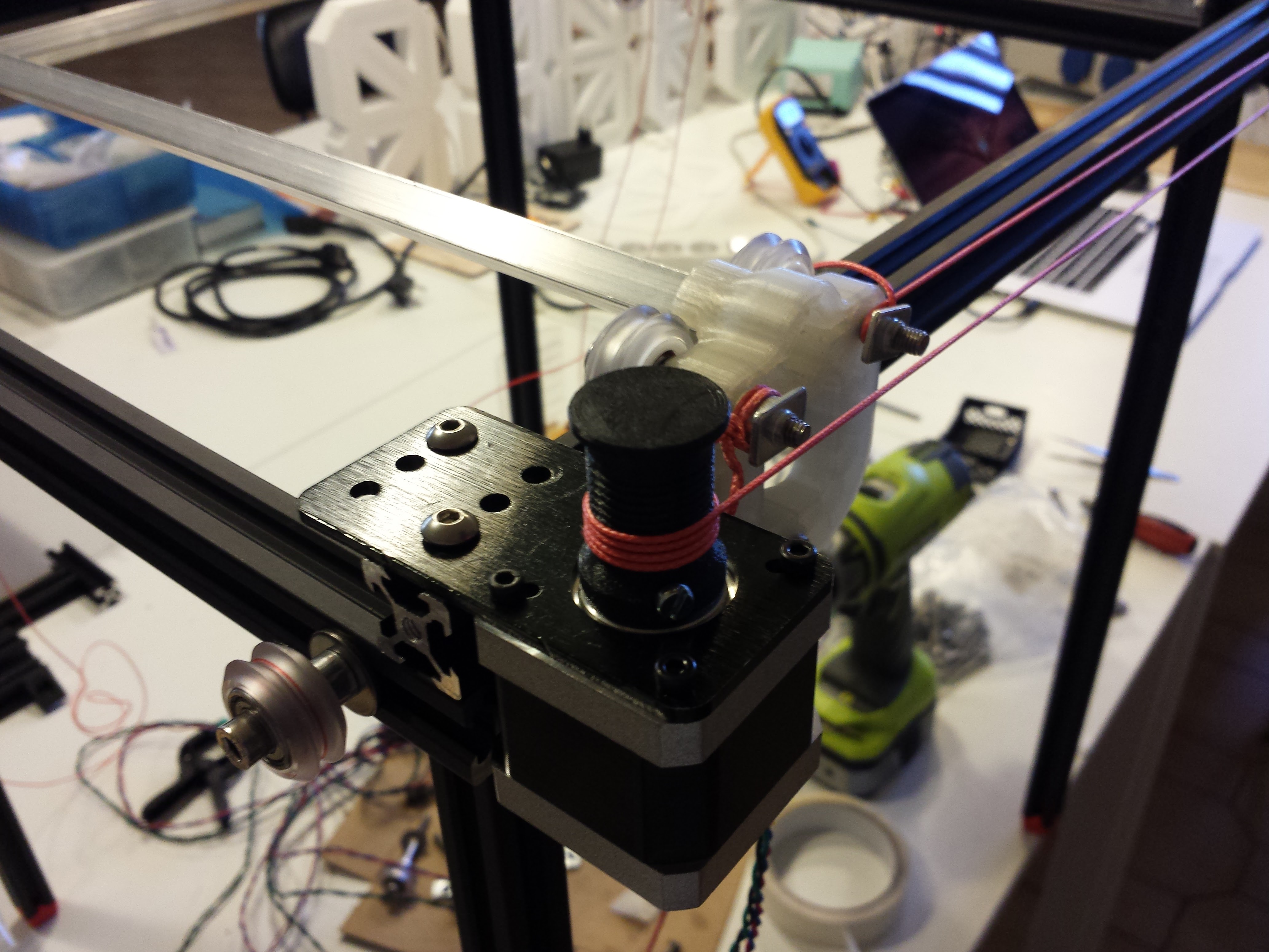

Exploring alternatives layout for QR. Difficult to make it better than the already excellent original one, but keep trying.
Findings so far:
- Vertical beam inside and semi-open carriage allow to free one side of the 20x20 extrusion for fixing Z leadscrew;
- Possibility to get rid of on wheel, but have to come up with alternative way to stretch Dyneema (Eccentric? Slotted stepper bracket? Screws on carriage);
- An L-shaped or even Y-shaped plate would allow to fix both stepper motor and idler in ideal position;
Let me know your thoughts…
