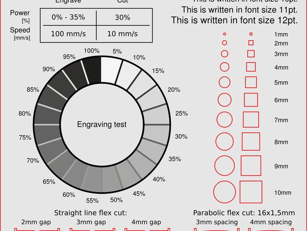

This is very dependent on your particular laser. You can search for recommended settings but itβs usually advisable to make your own determinations using a material test card. The link below is for Lightburn test cards but you will get the idea.
