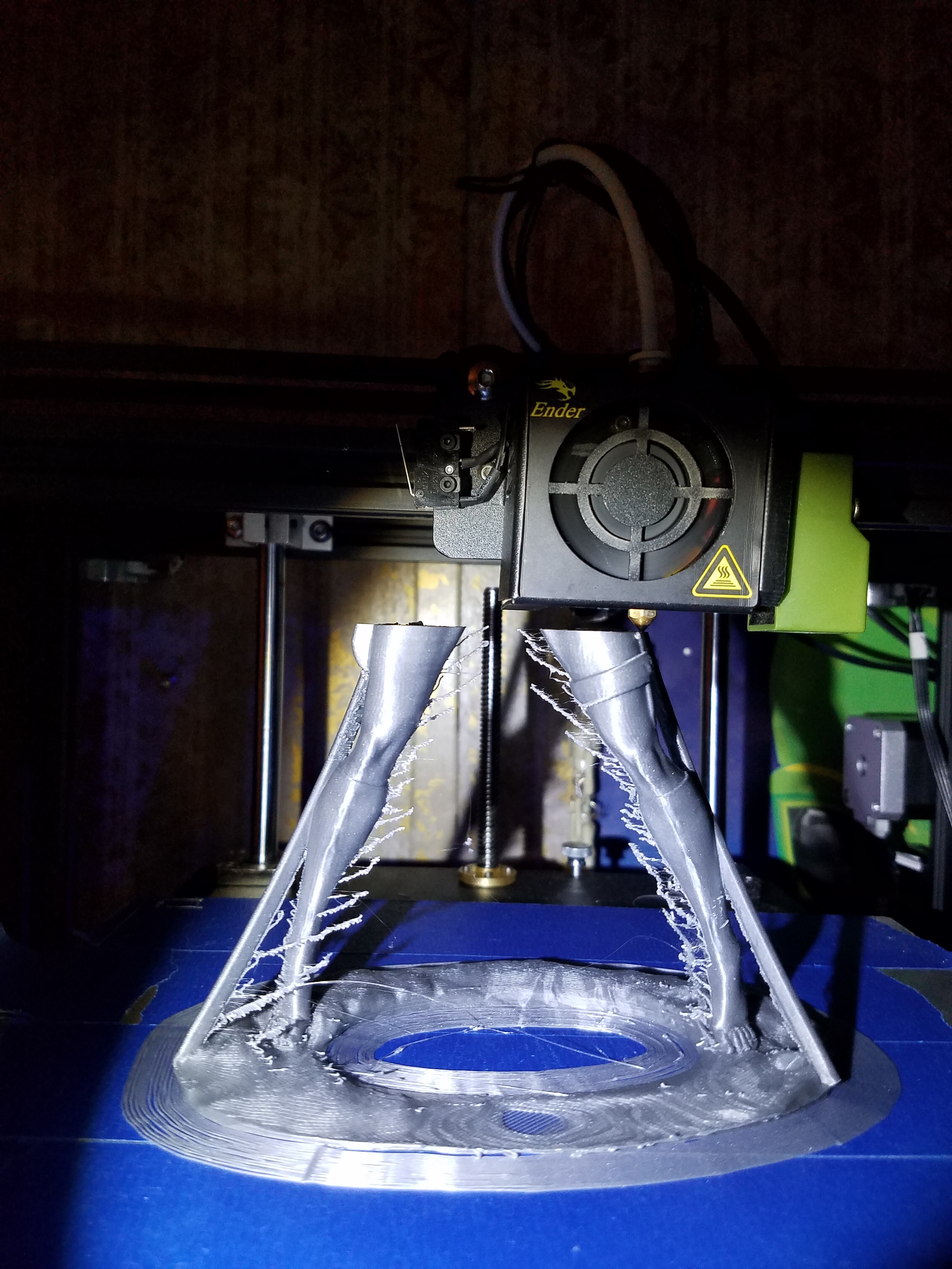

Extruder hitting high spots? What do I do?
Extruder hitting high spots? What do I do? Come on print!
You mean bumping into the print when you get above a certain levels? Add a Z hop when retracting. I needed to do that as well. I’ve since set my Z hop to .2 mm and it hasn’t knocked over a tall print since.

Hey. Try to increase infill or change infill pattern. Lowering temp several degrees might help.
Z hop will work but that’s just treating symptoms not real disease… imho

I’ve been running into problem with infill getting"bumpy." I was running boxes, but now I’m going to try lines. The “intersection” point would bump upwards so hopefully only having line infills will alleviate that.

Oh how I noticed it was infill for me… I had CuraEngine (in RepetierHost) do automatic infills and I think above 25% infill, it starts using alternating lines instead of drawing boxes every layer. So when I bumped up to 30% I’d have far fewer issues.
@Francis_Lee ok, yea I’m at 20% right now. So the plan for tonight is to lower the temp. Turn up the infill, change the pattern? (Maybe) and maybe try the z drop
Oh… Well something thin like those legs probably needs more than 20%. But yes, change the infill to lines or something that won’t intersect on the same layer.
Z-hop will make interesting artifacts too, sometimes it helps, sometimes it hinders.
For example, lifting a nozzle before jumping to another region can cause a “cat ear” to appear on that edge that it’s jumping from. Sometimes it helps though.
You’re going to have to experiment a bit, but your plan is a good start.
