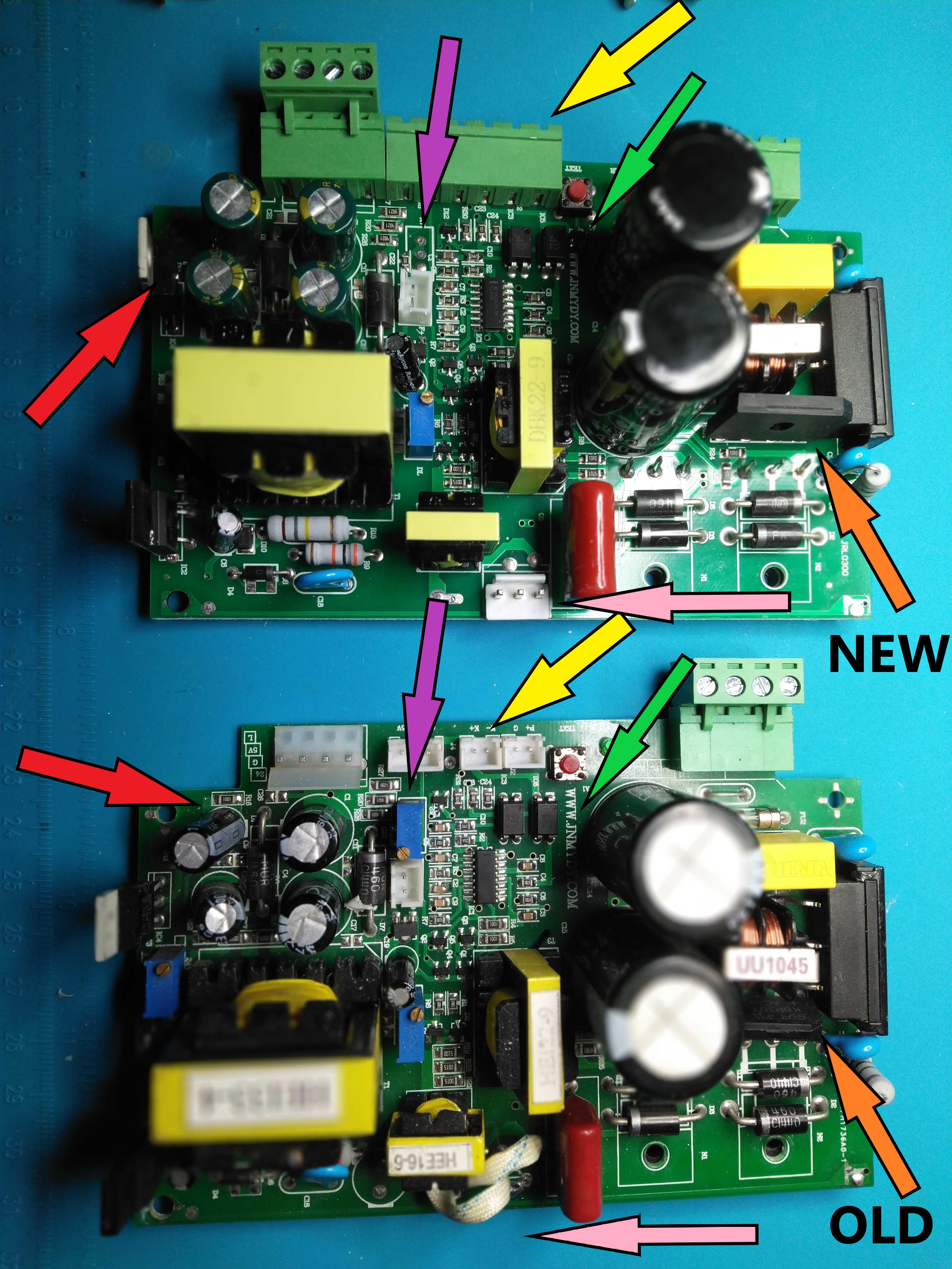

1: Red arrow. Better capacitors
2:Purple arrow. Removed fan speed potentiometer. Fan blow with full speed.
3: Yellow arrow. The front panel connectors were replaced with larger ones. Pin out similar.

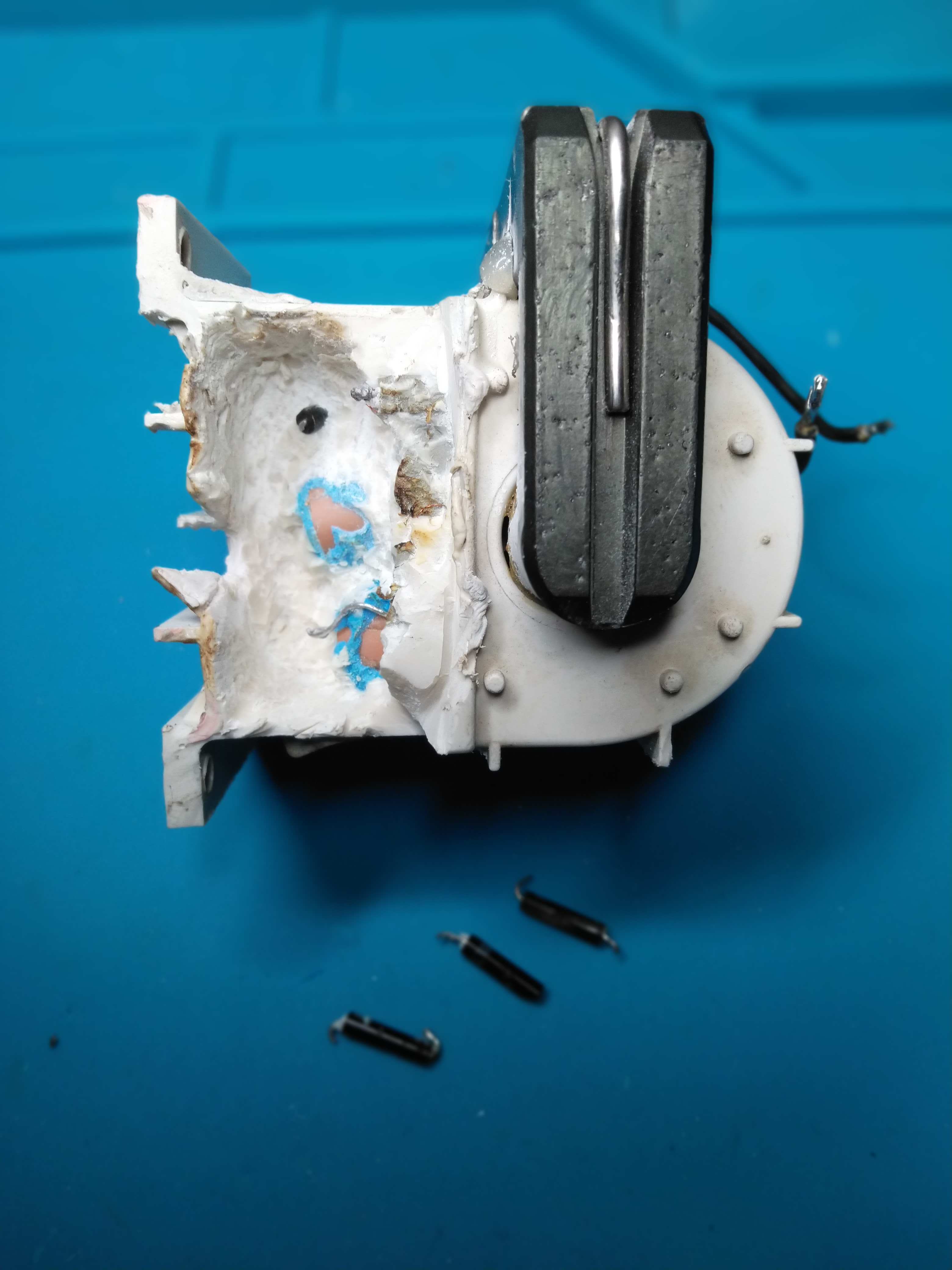

4:Rose arrow. The upgraded transformer got a new connector. Pin out same. The upgrade in the transformer probably the high voltage diodes and caps. I got the old diodes out from the potted transformer. But they are not marked. So no any details. I hope higher current models. Chienese high voltage diodes.
5.Green arrow. The test button was not connected for anything on the original one. (did not work)
On the NEW one. They put an extra transistor switched by the test button. And it is just paralel to the front test button.
6. They finaly replaced the bridge rectifier with a larger higher current version.
If you are interested what is in the high votage transformer.
It can be a voltage multiplier or just a full bridge rectifier with smoother capacitors.

The transformer was faulty. The voltage was not high enough.
I ordered the new transformer. So I had the oportunity to butcher it.
I think the high voltage diodes are probably about 25mA. That is why they die. Might just bad quality. And they brake down voltage gets lower.
But no evidence. No markings on the diodes.
I did not see the current limit resistor (R1 on the upper picture). Might I did not dig deep enough.
