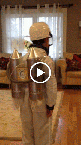

FastLED-based jetpack costume for last Halloween.
FastLED-based jetpack costume for last Halloween. The photo shows the prototype of the “guts”: a small strip of neopixels and a motor with a propeller. I recently tried to make some modifications (mainly to increase power to the motors), but now one of the neopixel strips no longer works. Is there an easy way to tell if I’ve burned out the LEDs or their tiny controller chips?

Btw, I forgot to say what a totally cool jetpack costume. Excellent rocket effect!
If you get around to testing bypassing the first pixel let us know how it goes.
Thanks! I’m hoping to get it fixed up soon. I’ll be repairing the LED strip (assuming that’s the problem), boosting power to the motors, and making better fabric “flames”. I’ll pose a new video when it’s done.
