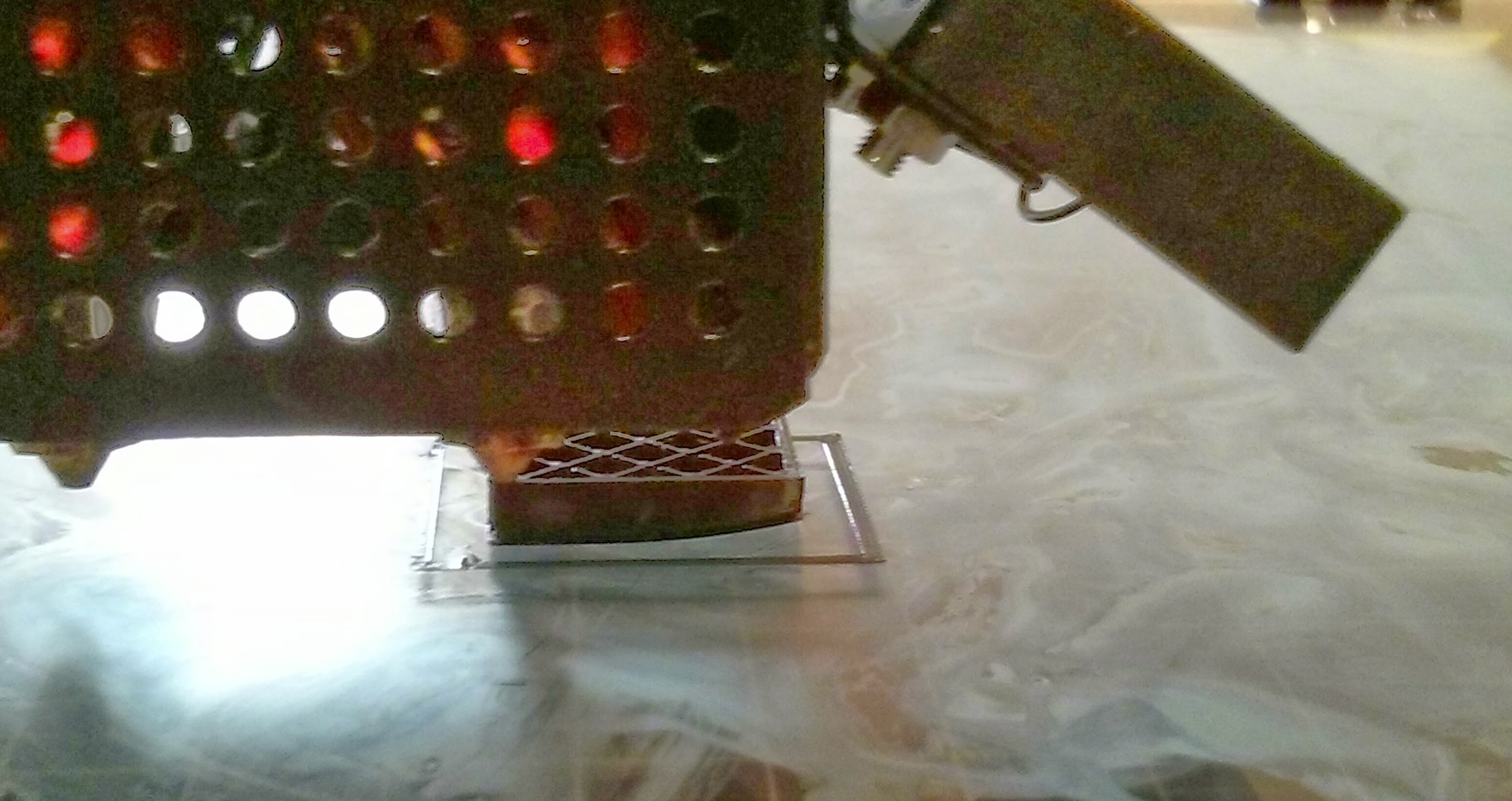

Feel the curl - first attempt with ABS. Bed at 80C, nozzle at 230C. PVA/Water mix on the bed (not a Ridley Scott laser smoke effect).
I think I need to turn off the head fan.
Yeah - you certainly do. ABS…no fans. Need stagnant, hot air.
I ran my bed at 100C for ABS and used hairspray on tempered glass.
I run 105-110 for abs. No fan
Ya try a hotter bed. 100C to 110C. I normaly run mine hot on the first layer then cool it off to 105C
Agree with the comments, ABS = no fan.
