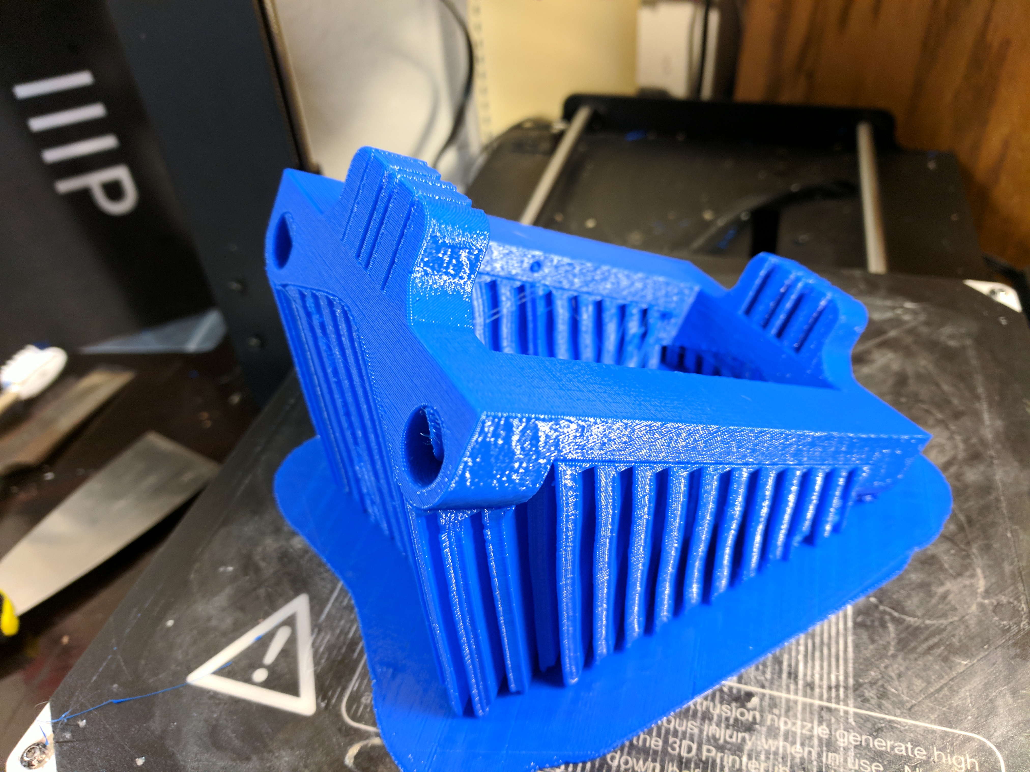

Feeling just slightly cocky, this evening. :) Printed an updated "boat" for my next-printer.
Feeling just slightly cocky, this evening. :slight_smile:
Printed an updated “boat” for my next-printer. Had to angle the print for better strength and more accuracy (with a dubious PLA filament). It worked.
Also, the print took about eight hours.
Getting more practiced at re-stringing the belts. Helps when your boat is not threatening to crack apart. Got decent tension on the belts, by hand(!).
(There are a few bugs in my prints. They will be corrected.)
The end result moves well in X and Y, with no play. The level of friction is high, but if I just wanted a 50mm/s printer, this might be sufficient.
I want a lot more than 50mm/s, but if result is this good for plain PLA structure, should do a lot better with better bearing materials.
Need to sort out the Z platform next. After that, will have no choice but to sort the electronics and software.
