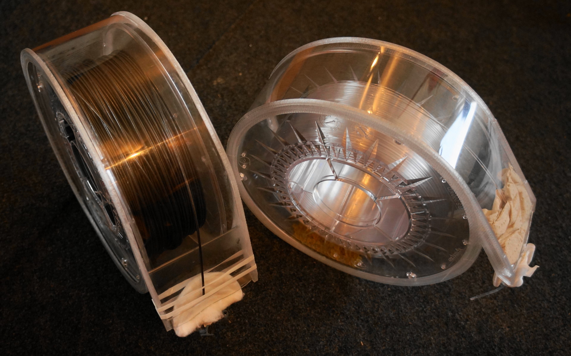

Filamentkassette d312|16 After I learned that humidity must keept low for good printing results,
After I learned that humidity must keept low for good printing results, I made these cartridges for my filamentspool.
You just print the 2 rims (mirrored left right) and put a 75×7cm Stripe in between in the slot. I put a cleaning pad in to seal the outlet
(You may notice the orange beads of silica gel at the bottom - turnig clear when water is above 7%) Probably I will add a tubing to also secure the filaments path till the hotend.
