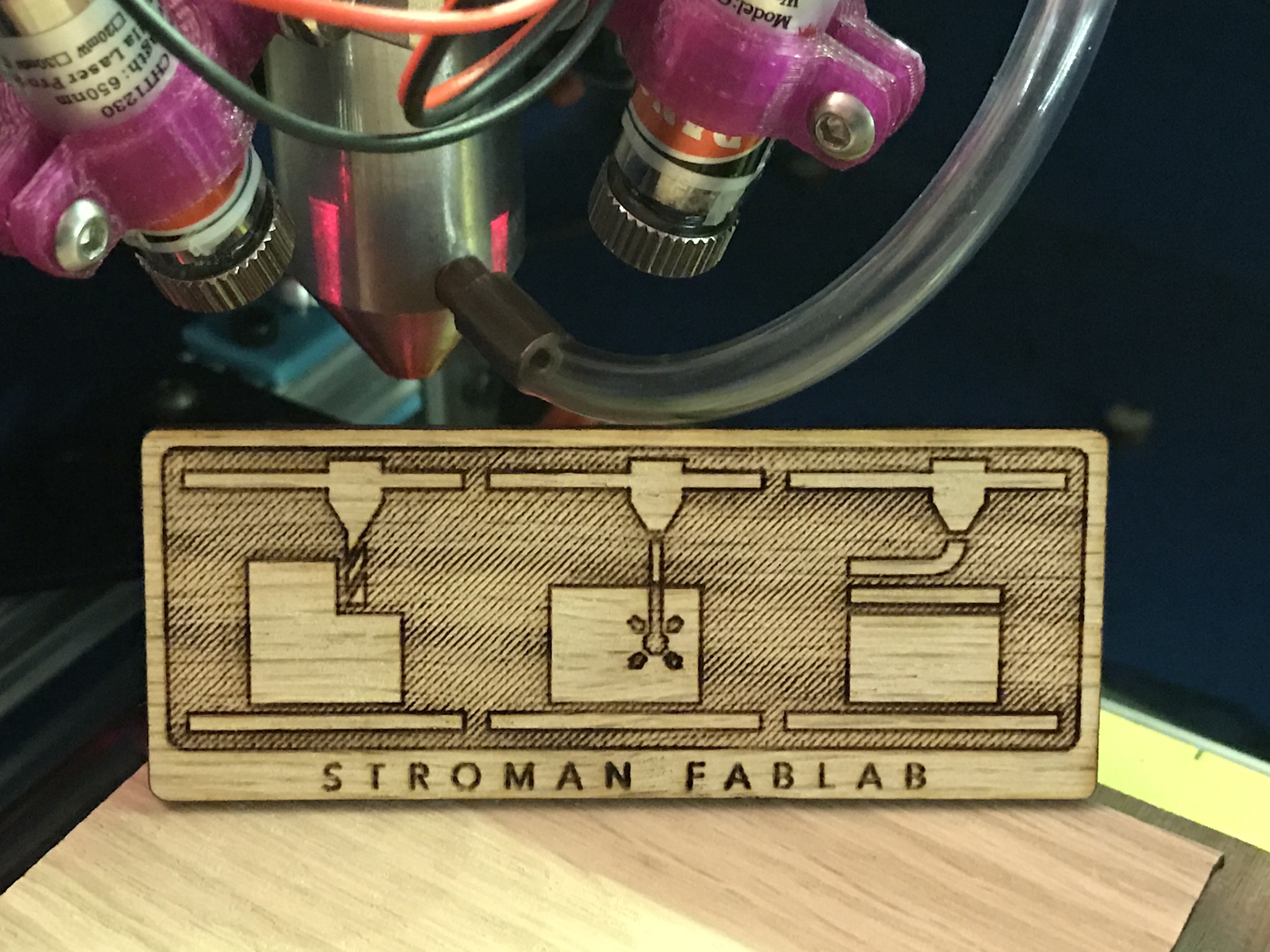

Fill Path now has a Line Angle setting. I also improved performance on Fuller_projection_rotated_screwvert_v02.svg.
Shrink it to your target size before generating; It takes longer at larger sizes.

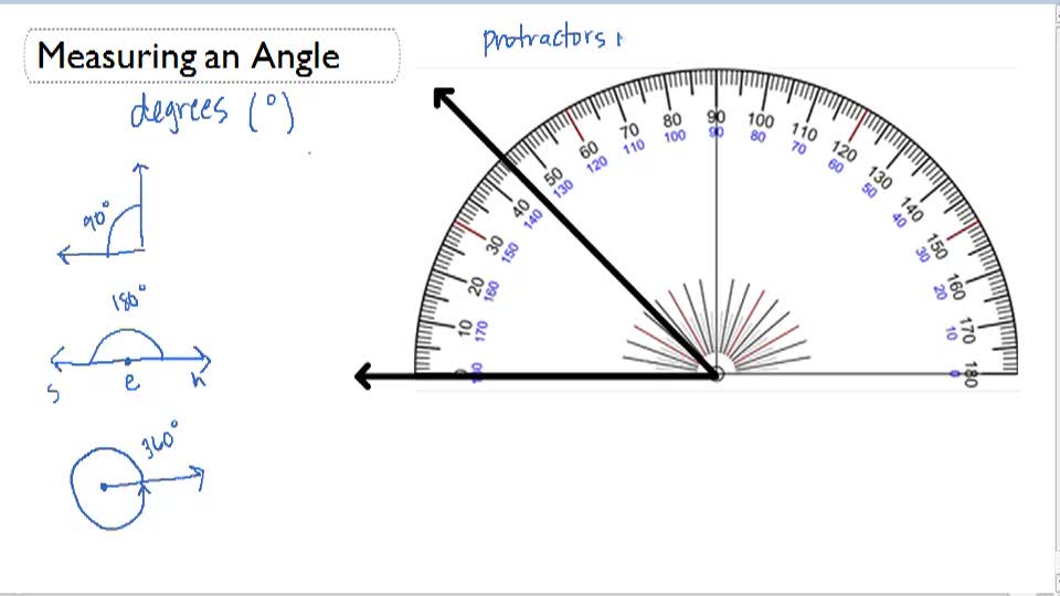

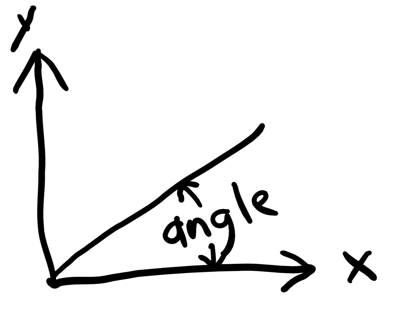

Very cool, question should 45 start from 0,0
@Todd_Fleming you killed with ^. Still my mind was expecting 0,0
I went with the orientation used in Trig and Calculus textbooks.
Do a google image search for: trig unit circle
no need I understand. I just need to remember that 315 is what I want
