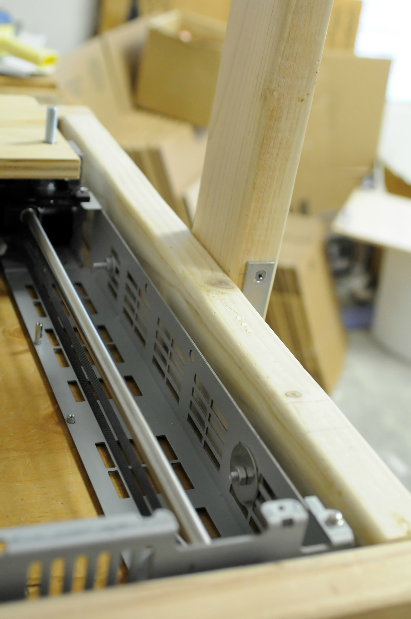

Final part of the mechanical construction complete with the stabilization of the Y-axis. This is done by tying the bottom carriage of the old scanner with its associated belt movement to the wood assembly. This is done with a 1/4" threaded rod cut in half and secured to the outer 2x4 and the metal carriage in two places. This not only serves to stabilize the bottom but the double-nut assembly allows fine tuning later to ensure that the rails of the Y-axis travel in a direction perpendicular to the travel of the X-axis. Why not use 1/4" bolts instead and not an assortment of washers and nuts? Well that is what I had in my coffee can of stuff, so that what was used. No reason to buy something if you do not have to!
