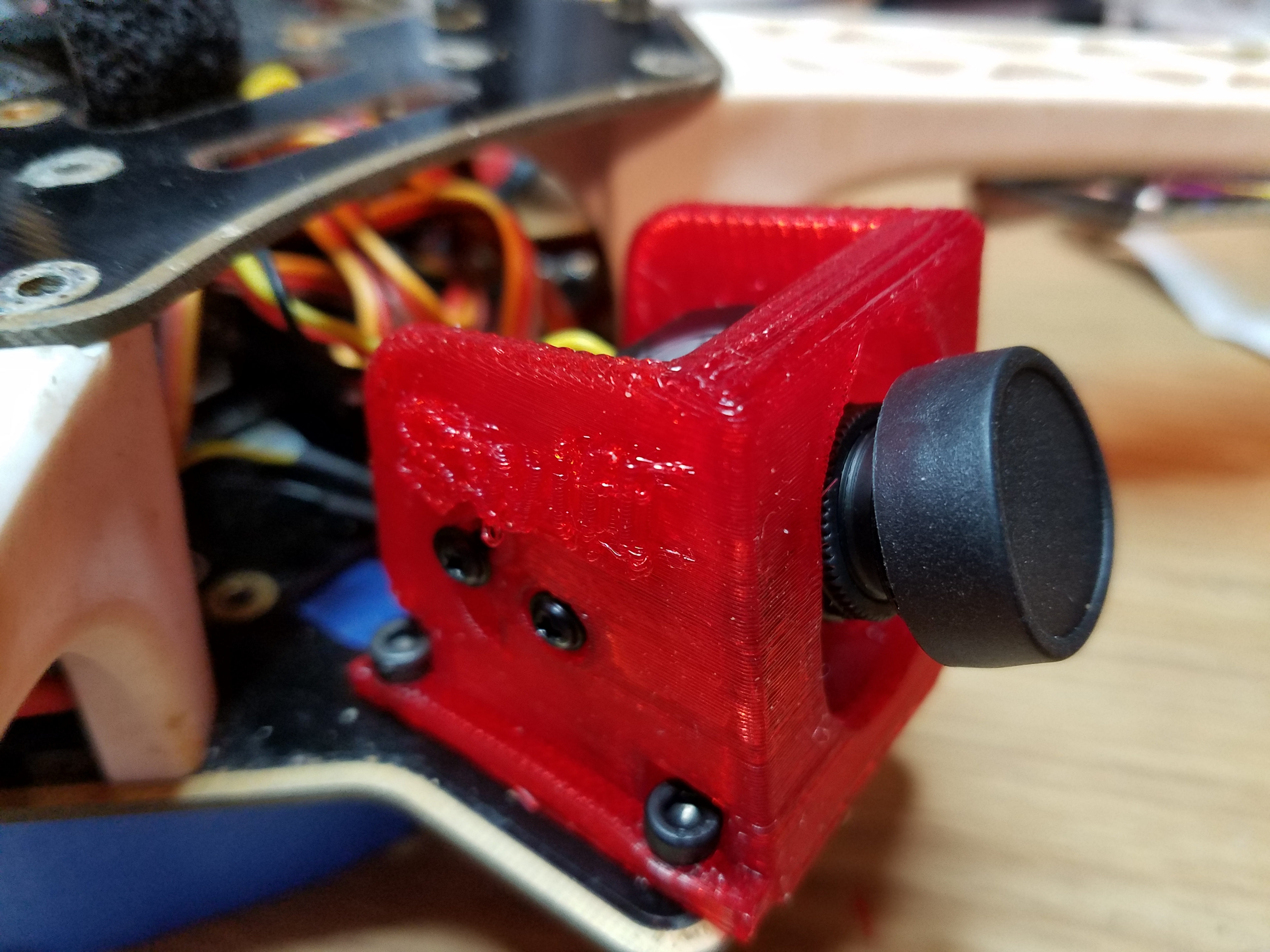

Final revisions of my Runcam Swift mount and my new VTX mount.
Final revisions of my Runcam Swift mount and my new VTX mount. Since nobody makes a mount for an FPV camera for it I made my own. After several failed attempts to rework something made for the Swift I did my own. It’s hard to tell from the pictures but on the one side I put ‘Runcam’ and on the other I put ‘Swift’. Since I had no good measurements to go by I used rough estimates hence the five versions. This was all printed on my Afinitbot A9 in TPU. After looking around online for the best settings for printing in TPU I’m using the same settings I use for PLA. The first layer is printed at 230 degrees and a speed of 10mm/s. I use a wider brim to get better adhesion. The rest of the print is done at 220 degrees and 40mm/s. I still have some minor adhesion issues on teh start so I hold down the extruded filament for the first part of the first loop. Looking forward to getting it in the air.
