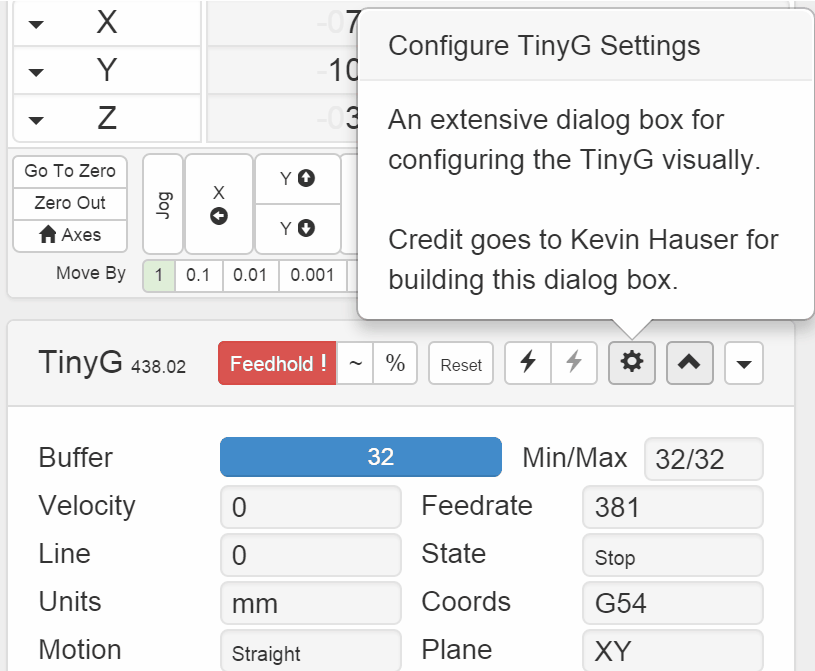

FINALLY! A configure dialog for TinyG. Thanks to @Kevin_Hauser

This is really awesome, nice work Kevin! I assume the code is out in jsfiddle land somewhere? I’d like to see how this was accomplished under the hood. Did John expose some special hooks for you in the Serial utility or is this all just accomplished via gcode?
Hi Anthony, it’s all just standard pubsub. Every widget has a “pubsub” menu item in the upper right corner under the little caret. You just publish to those signals or subscribe to them. So, all of ChiliPeppr is self-documenting. Kevin just used that. I use it too, i.e. I eat my own dog food. All of ChiliPeppr was designed that way. So, anybody can do it. Even the macros are standard code. In fact, you can fork Kevin’s widget in the same upper right corner menu of his dialog box.

@Kevin_Hauser TinyG v.438.09 (not released yet) changed some of the settings for power management. You can read about it here:
@Kevin_Hauser we should think of a value to say which version the config widget applies to. I think perhaps saying your firmware is too old as john does is the best bet. This way people trying to configure old values on new firmwares are not confused.
