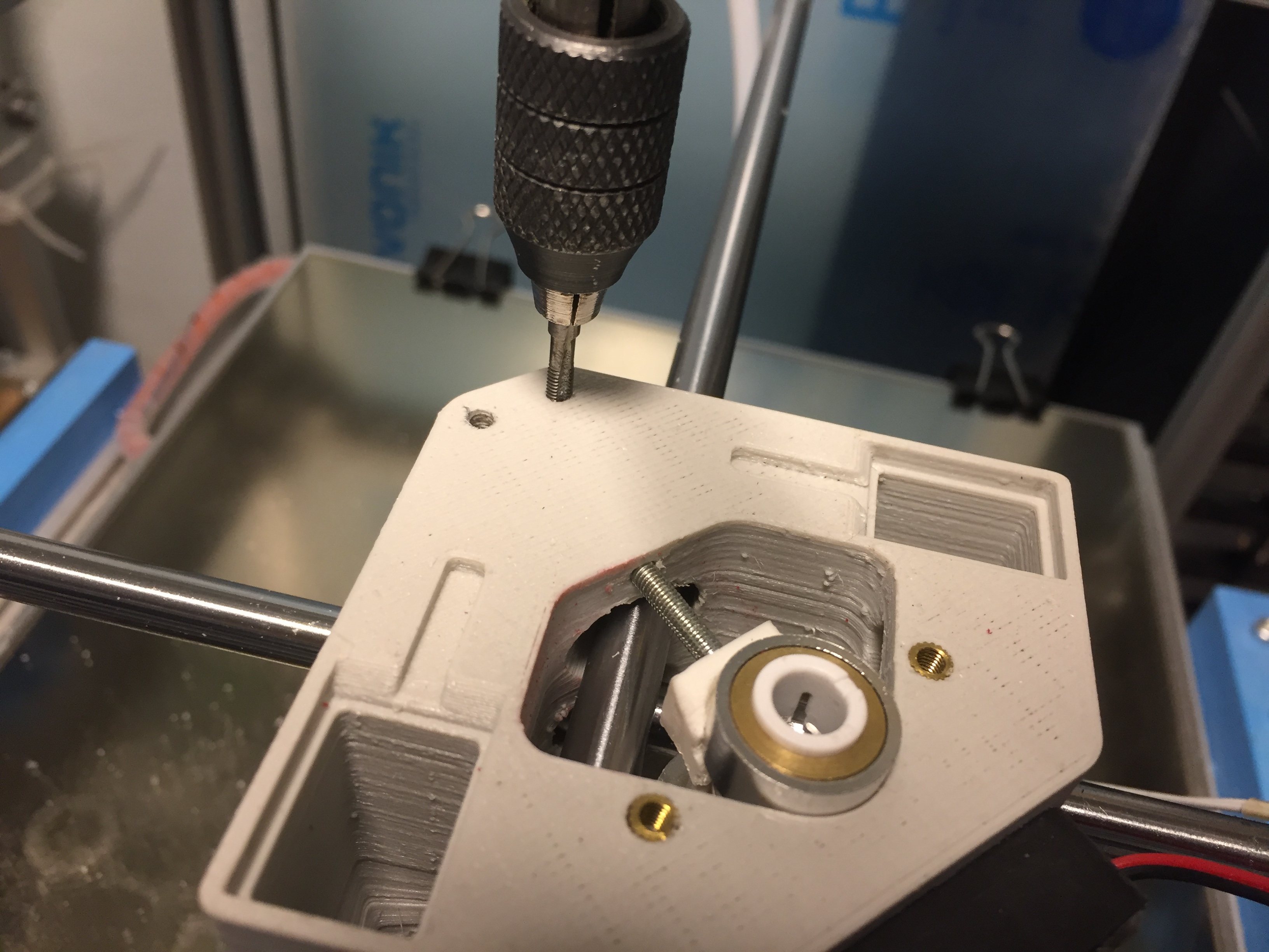

Finally added part cooling fans
I didn’t want to glue the fans to carriage so I designed a little fixing clip that holds the fans. It can be printed mirrored.

Good Thinking! If you can put the parts in the Community Mods area, I would like to use them on my carriage. I just finished adding tapered bores to teh .stp model for M3 Heatserts and clearance screw holes for the hotend clamps and thickened the edge around the fan hole on the face.
@Dennis_P added the part file to the Eustathios-Spider-V2/Community Mods and Upgrades

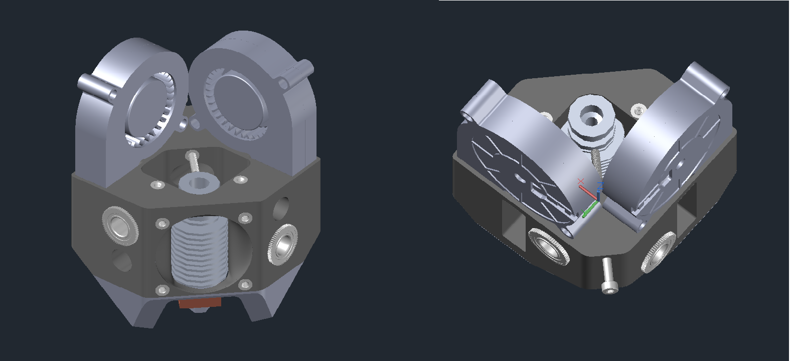

Here is my carriage model from the step file @Walter_Hsiao kindly included in his mods, with
Fans from grabcad
https://grabcad.com/library/radial-cooling-5015-fan-50mm-dc12v-1
E3D from grabcad
E3D Hotend: https://grabcad.com/library/e3d-v6-1-75-hotend-1
and other part files from McMaster
bearings: https://www.mcmaster.com/#2032N24
M3 Heatserts: https://www.mcmaster.com/#94180A333
