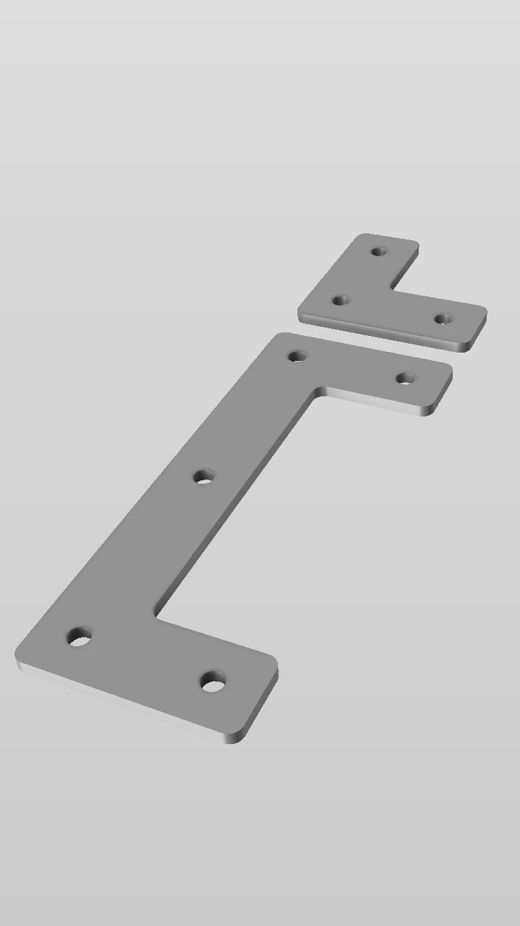

Finally after many many months,
Finally after many many months, I am back to working with my cnc and cutting parts for my 3D printer build. I can def up my federate with this 3mm endmill.

Use less stick out on your tool it reduces rigidity as a cube, so half your stick out 8 x the rigidity. Especially with a small tool like that it’ll help you go faster.
I am curious to know the feed rate. I’ve got some 1/8 in aluminum I would like to cut some mounting brackets out of.
I’ve found something interesting with this flat stock. Different pieces of the same stuff cut VERY differently. The first few I did I was able to do 150mm feedrate, with 100mm lead in/out… but the last couple I did I had to constantly lube to avoid melting and dragging. I even tried different bits. I’m moving from a 2 flute 3mm to a 4 flute 4mm flat end mill to do the rest. Will let u know how that goes.
I think you are not doing enough chipload and the Bit is going dull?
Your Chips are very fine, so the endmill may Pack up.
Maybe try dropping rpm?
I could do 500-700 mm/min feedrate at about 10.000 rpm and 1mm depth of Cut.
With a China 2 flute 1/8 Flatrate endmill.
Done in my small (340mm) self made mill Router.
Then i get some nice small Chips flying around. But you will get some decent deflection and you May want a finishing pass with a 2/10 mm full depth or so.
Ok, i see where i need to start testing. Ive broken a few bits (thankfully I have a LOT of these 3mm end mills). Still hitting points where it will gum up, but at least Im on the right track, thanks @Andre_S !

Great success, this is what ended up working without issues for me. I had to drop the step down to 0.5mm, anything more would snap the bit.
