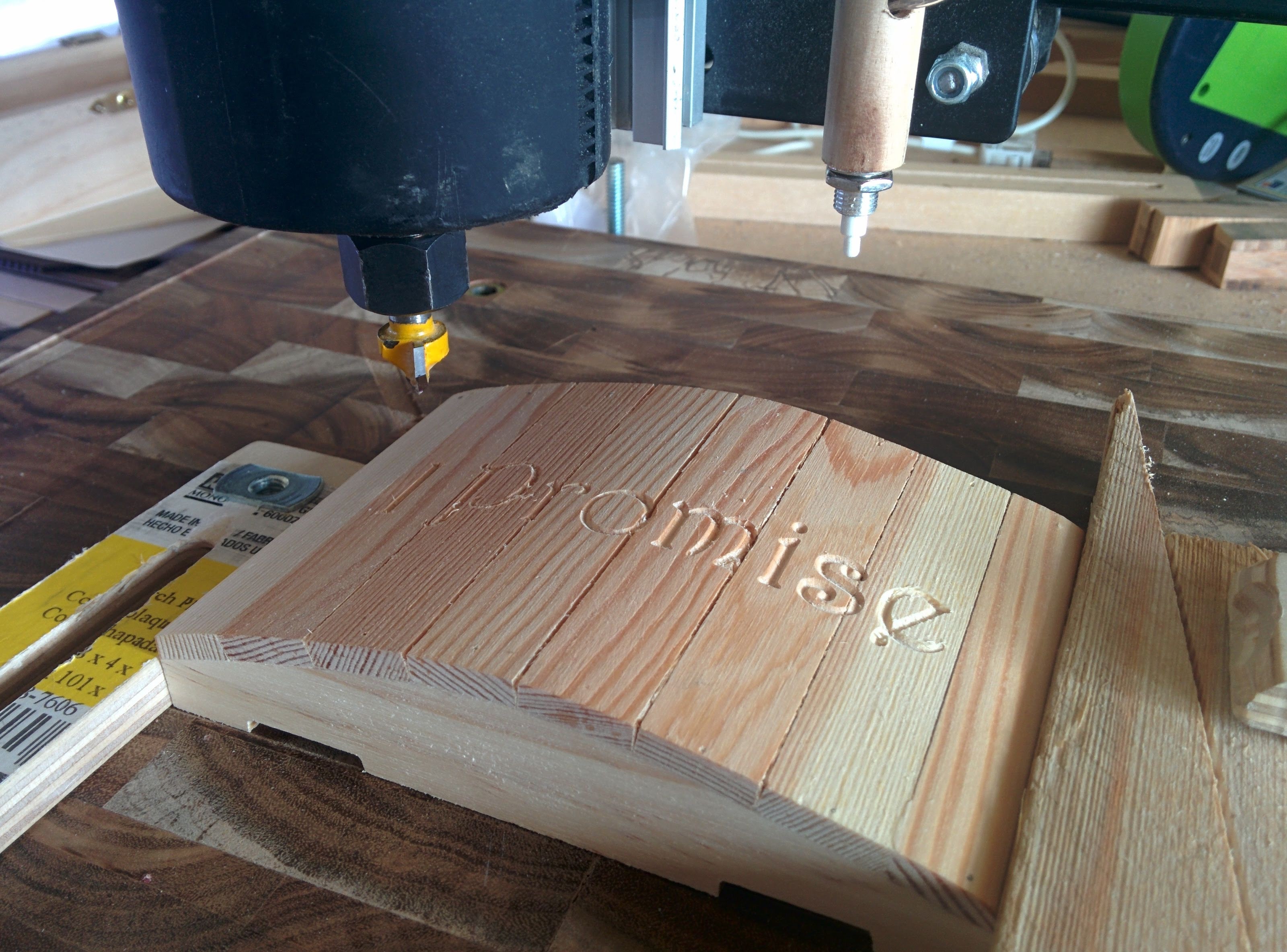

Finally built my z probe. Now I can load the vcarving tool path into gcode ripper and wrap it around curved objects.

Sure. the probe is just a cheap switch from radio shack. I wired it up to an input terminal of my parallel break out board. Told LinuxCNC that that input should be recognized as a probe input. Then calculated the offset from the tool tip to the probe tip. then loaded the toolpath into g-code ripper. http://www.scorchworks.com/Gcoderipper/gcoderipper.html told it i wanted to add probing and plug in the probe offsets and how many probe points on the surface of the curved piece i wanted. Then just save out the new gcode and run it.
You have to be careful how you hold down the part since it is real easy the crash the tool or the probe as it’s probing the part into one og the hold downs. So clamping pressure from the side or double sided tape are your best bets…
Its the same kind of idea that they use for milling pc boards but that’s easier because you can use the pc board copper clad and the milling bit them selves as contacts.

@Bruce_Lunde just made it up. Got a 1/2 inch dowel and bored out the center deep enough for the switch to fully seat and have room for the wires to hang out. Drilled a hole in the side for the wires to exit. Got a block of wood and drilled a 1/2 inch hole in it. And slotted the piece to the hole drilled another hole 1/4 inch and put a threaded rod and nut on it to make a clamp for the probe. And slapped it all on the z carriage.

Mach3 has a digitize wizard that can read the 2½D surface of any object, if you have a proper probe with a known ball probetip that can read touches in down and side movements.
With that you can get a curved plane to import into any decent 3D program.
From there you can add text or patterns to be carved on the curved surface and then generate NC code.
