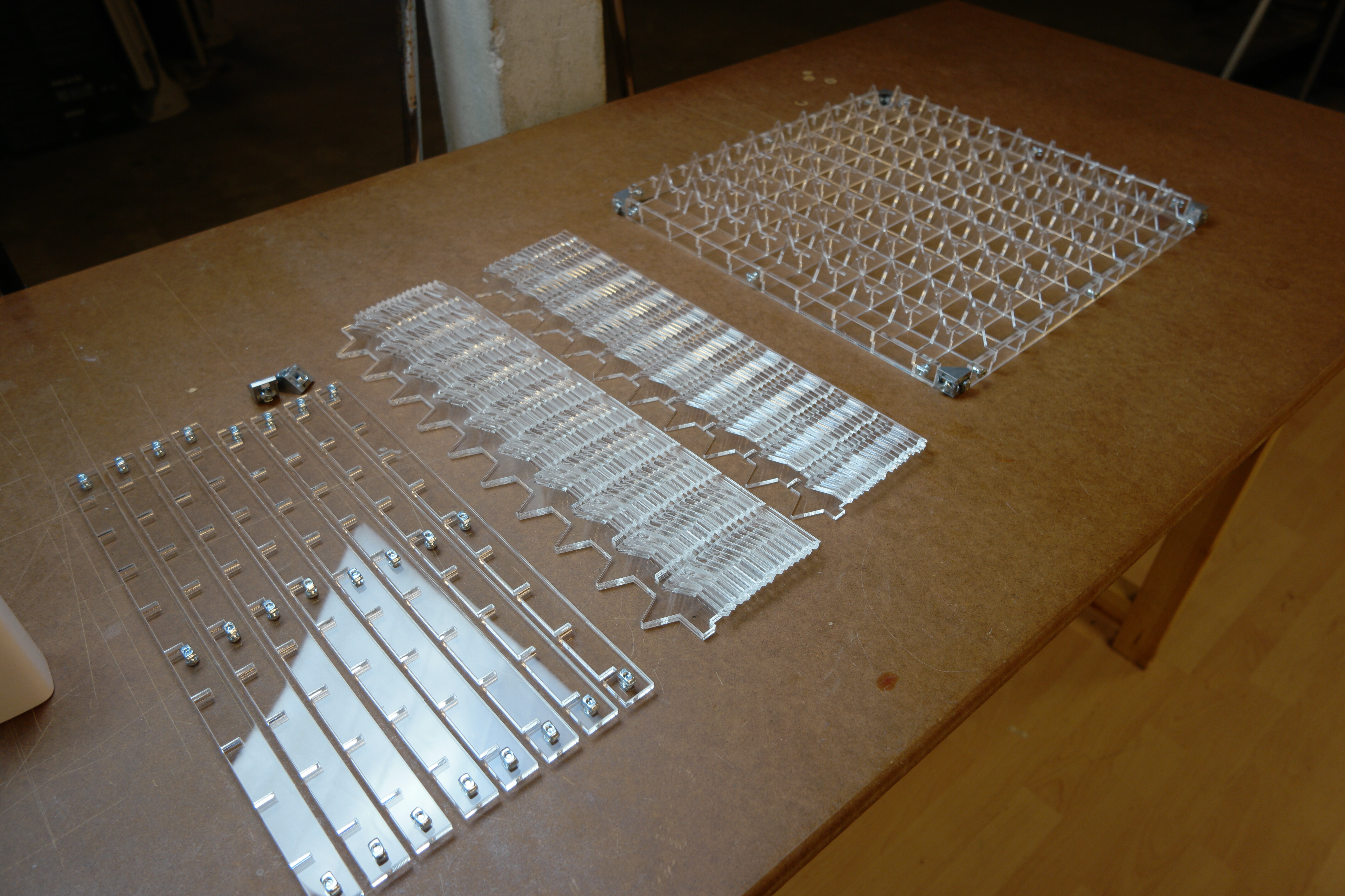

Finally came around to cutting the other 3 compartments so my Bed can get
Finally came around to cutting the other 3 compartments so my Bed can get completed… just need to assemble it Now.
Cause the first one is holding up nicely, ofc it’s getting some marks here and there but it doesn’t affect acrylic, but when cutting mdf it is visible however, but as I’ve read here masking tape should do it :slight_smile:
Great job on the bed. Would you be willing to share the design files for this?
Thx @funinthefalls , I can share them, how would you like them? I can give you, CamBam file, dxf file and jpg file with the dimension included?
DXF would be great, I can import that into LaserWeb.
You get them All… :slight_smile: you might get some scaling issues when importing, so I’ve added Dimensions as Layers and pictures with absolut height&length. The 3 Layers are:
ProfileHolders(5mm Acrylic)
SharkTeeth_Hori(3mm Acrylic)
SharkTeeth_Vert(3mm Acrylic)
https://drive.google.com/drive/folders/0B3-WzWhvXB8EQmZOVDdZbHdtazg?usp=sharing
Thank you.
Looking good, i should try that too instead of moving 150 nails every time my acrylic bed is worn out :slight_smile:
Woooow 150 nails… hehehe now that would get boring real fast, I imagine!!! :smiley: well you can give it a try, for me I must say it worked better than I thought! although it was just a test :wink:
