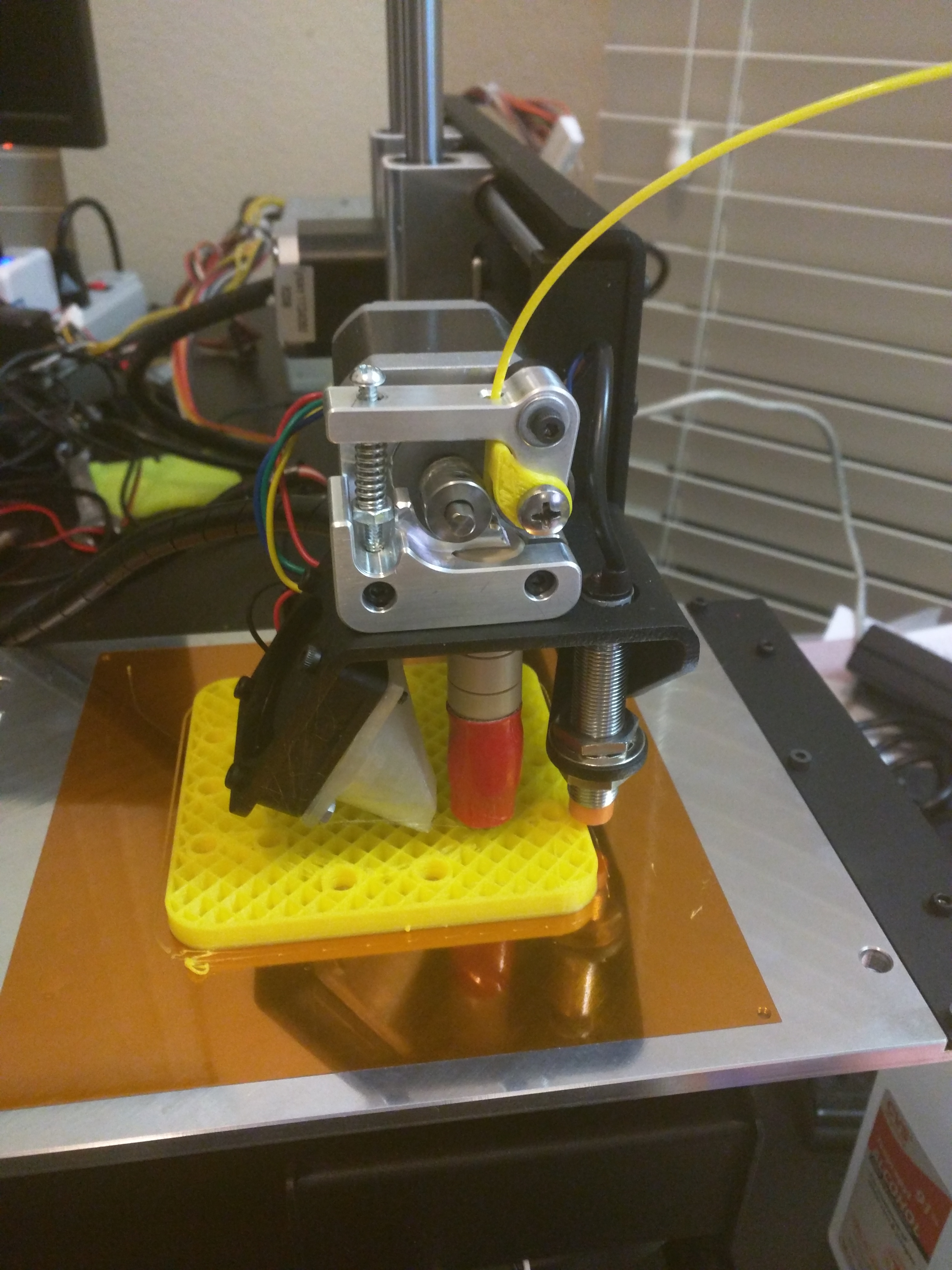

Finally get the design for the spindle plate done.
Finally get the design for the spindle plate done. Time to finish up this ox so I can mill aluminum plate for our program.
I’ve thought about trying the same thing, but why not more infill?
Once happy, I am getting it milled from polycarbonate or aluminum.
